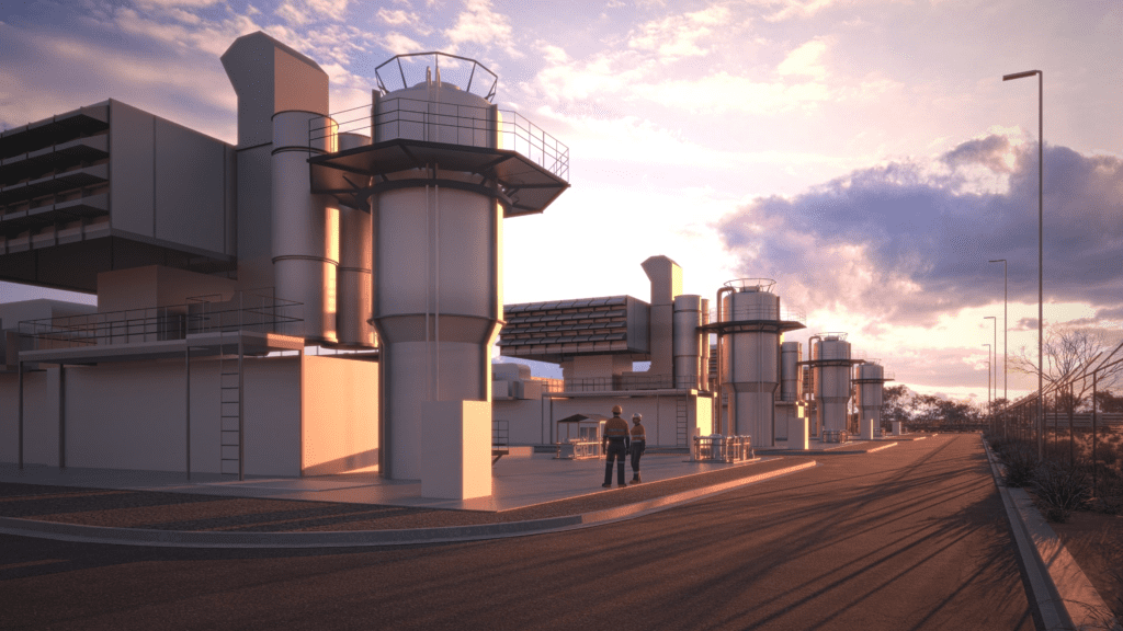

A rendering of the Whyalla hydrogen power plant, featuring GE Vernova’s LM6000VELOX package—the first aeroderivative gas turbine solution designed to operate on 100% renewable hydrogen. Four LM6000VELOX units are planned for installation at the Whyalla complex in South Australia’s Upper Spencer Gulf, providing critical firming capacity to support the state’s energy transition. Courtesy: OHPSA
