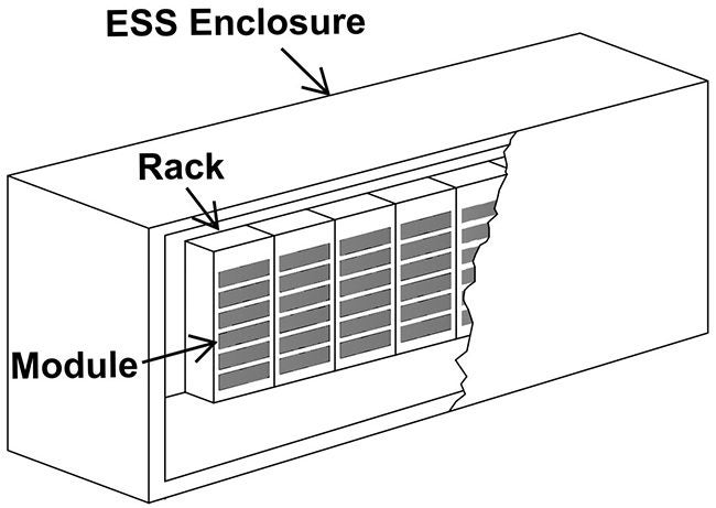

An energy storage system (ESS) enclosure typically comprises multiple racks, each containing several modules (Figure 1). These modules consist of numerous lithium-ion (Li-ion) cells, which function as rechargeable batteries designed to store and discharge electrical energy. In accordance with National Fire Protection Association (NFPA) 855 standards, ESS enclosures must be constructed from noncombustible materials and adhere to specific dimensional limits, not exceeding 16.2 meters (m) in length, 2.6 m in width, and 2.9 m in height (53 ft. x 8.5 ft. x 9.5 ft.).
1. An energy storage system (ESS) enclosure. Courtesy: CTCI
