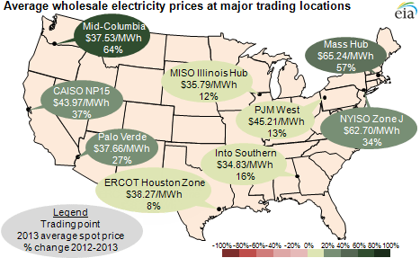

As in 2014, monthly average wholesale electricity prices were typically highest in the Northeast. They were often the lowest at Mid-Columbia in the Pacific Northwest, where hydroelectric dams are a plentiful and low-cost resource, even though water and snowpack levels in 2015 were low compared to historical averages, the EIA said.
EIA_MonthlyAveragePrice
