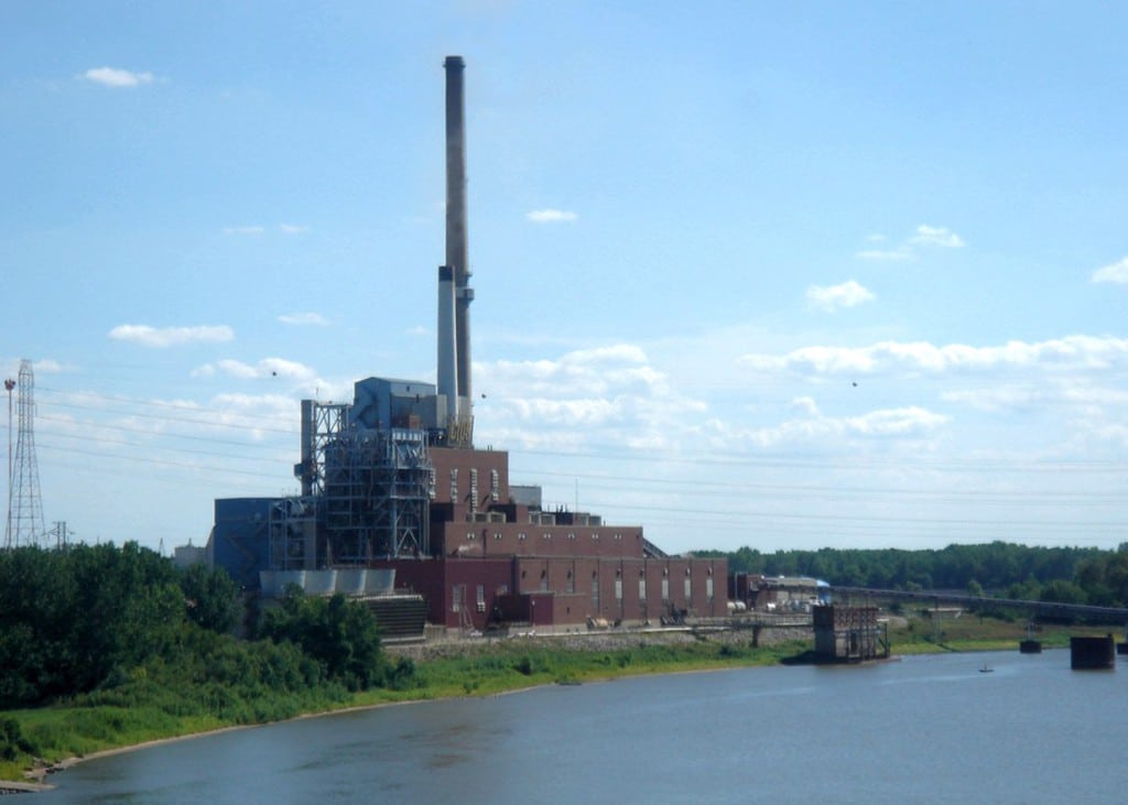

The DOE earlier this month announced it would award $1 billion in Recovery Act funds to the revamped proposal. The so-called FutureGen 2.0 project contemplates repowering of an existing Ameren 200-MW coal unit in Meredosia, Ill., using oxyfuel technology—not construction of an integrated gasification combined-cycle facility at Mattoon, Ill., as originally envisioned.
