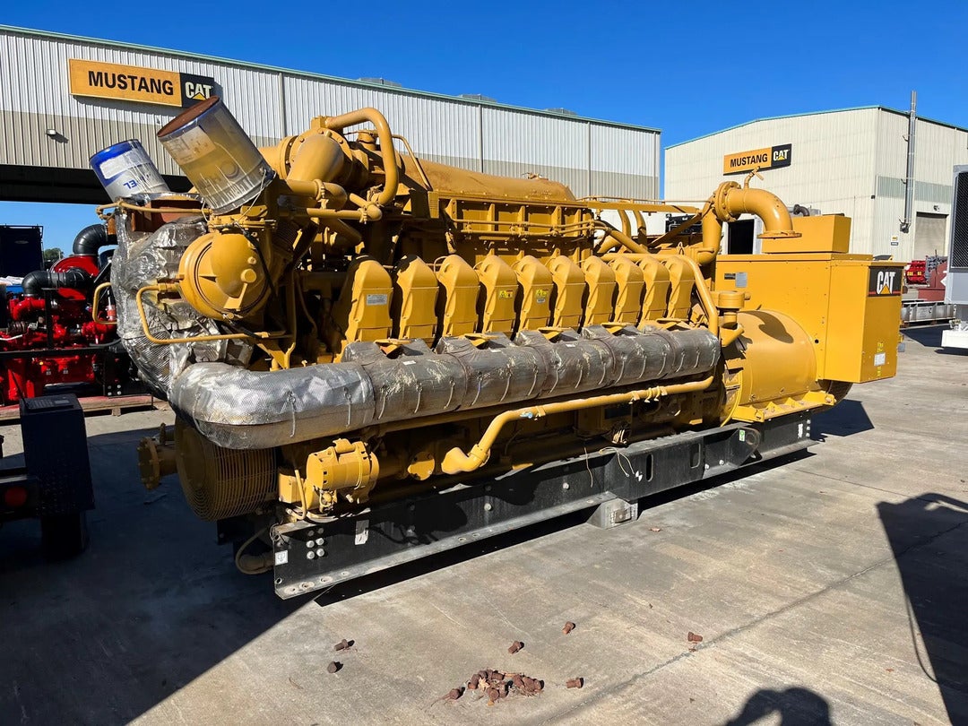

Take the case of the massive data center campus being developed in Millard County, Utah, by Joule Capital Partners, Caterpillar, and CAT dealer Wheeler Machinery that could eventually add up to 4 GW of power. At its heart will sit a fleet of Caterpillar G3520K generator sets (Figure 1) and more than 1 GWh of battery storage. These engines will run on natural gas and be used for prime power. Each one has an engine speed of 1,500 RPM and a power output of 2.5 MW. The system produces electricity and captures waste heat to power and cool high-density AI servers.
1. A CAT G3520K gas generator. Courtesy: Caterpillar
“The full generation package can be delivered ahead of most other generation technologies,” said Melissa Busen, senior vice president of Electric Power at Caterpillar. “This speed-to-power advantage is critical for meeting the explosive growth in demand for compute capacity.”

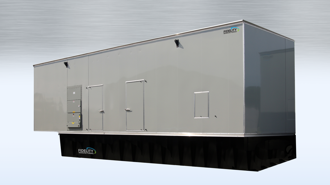

The demand for generators has created growth not only for the factories that build the gensets, but also for the companies that package the open-engine generator. Fidelity Manufacturing of Ocala, Florida, for example, is facing an unprecedented era of expansion. The company manufactures custom steel fuel tank sub-bases, and aluminum tube frame enclosures (Figure 2), as well as stairs, platforms, and walkways to supply complete generator packages for engines from Caterpillar, Cummins, Rehlko (formerly Kohler), mtu, Generac, Blue Star, and others.
2. A typical generator enclosure package from Fidelity Manufacturing. Courtesy: Fidelity Manufacturing
“We have grown from 40 people to more than 500 in less than a decade, with data center demand for generators being a significant part of that growth,” said Mitch Twardosky, Fidelity’s CEO.
The company has opened a second 86,000-square-foot factory near its original 76,000-square-foot facility to increase capacity. It also has a five-acre asphalt storage area. Another three and a half acres of storage space is under construction, along with a 25,000-square-foot production building and a 25,000-square-foot warehouse.

“Data center managers should pay attention to the acoustical performance, reliability, and longevity of any gas generator package they are considering,” said Twardosky.
He recommended choosing an aluminum tube frame with aluminum sheeting over the traditional steel structure due to their strength and rigidity as well as corrosion resistance. Additionally, aluminum designs are much lighter, which aids in transport logistics and ease of installation onsite.
Design is driven by the American Society of Civil Engineers (ASCE) Structural Engineering Institute (SEI) requirements or state/local building codes, depending on the location. These take into account hurricane, earthquake, and weather protection, as well as electrical safety and other essential code points.
Generator packages can include features such as a radiator-mounted load banks, generator output circuit breakers, a neutral ground resistor, LED lighting, plenty of internal and external outlets, as well as power distribution panels, transformers, battery chargers, ventilation fans, emergency stop stations, and space heaters. Most generator manufacturers, added Twardosky, produce the engine/generator and have someone else package it and install it onsite. Fidelity has a service division that installs the packages onsite, both for its own enclosure packages, as well as packages from other vendors. The company is a licensed electrical contractor and a licensed certified building contractor, providing the skills needed for the complex installations.
Stairs, platforms, and walkways are needed for access to an enclosure package. They should never be an afterthought. They should be built in compliance with Occupational Safety and Health Administration (OSHA) and International Building Code (IBC) standards, composed of an aluminum tube frame decked with molded fiberglass grating in high-visibility yellow.
“Data center managers should look for strong, anti-slip surfaces with chemical resistance to fuels and petroleum products,” Twardosky advised.
