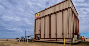

California-based Rondo Energy said its 100-MWh Rondo Heat Battery (RHB) has entered daily automatic operation, with energy provided by a solar photovoltaic array. The system is delivering continuous high-pressure industrial heat and steam to an enhanced oil recovery site run by Holmes Western Oil Corp.
Rondo on October 16 said Holmes has replaced one of its natural gas-fired boilers at a project in Kern County, California, with a 20-MW solar array paired with Rondo’s 100-MWh battery. The battery heats clay bricks with electricity, generating steam that is then used to force oil from the ground.
Rondo on Thursday said its unit sets new records for an industrial heat battery in terms of capacity, round-trip efficiency, and power supply, with a 100-MWh unit delivering a volume of heat equivalent to 10,000 home heating systems.
The off-grid solar PV charges the heat battery during daylight hours, and the RHB delivers heat 24 hours a day. Rondo said that after 10 weeks of operation, the project has achieved all milestones for daily automatic operation, performance, efficiency, and reliability proving out Rondo’s unique design, which boasts storage temperatures above 1,000C, and round-trip efficiency above 97%.
