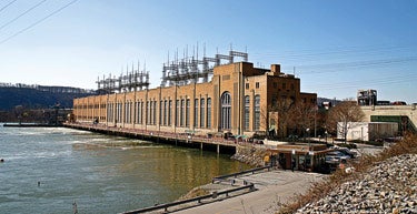

As the Pennsylvania, New Jersey, and Maryland Interconnection (PJM) became the most active and liquid market for bulk power in the U.S., Safe Harbor Water Power Corp. (Conestoga, Pa.) recognized the opportunity to use a computerized method of optimizing its production scheduling to maximize its profits. The Safe Harbor station (Figures 6 and 7) is a 12-unit facility with an installed capacity of 417 MW. Immediately below it is the reservoir for the Holtwood plant, which has 10 units with a total capacity of 115 MW.
6. Water under the bridge. The advent of regional, online wholesale electricity markets created an opportunity for Safe Harbor Water Power Corp. to optimize the performance of its hydro plants. Courtesy: Safe Harbor Water Power Corp.

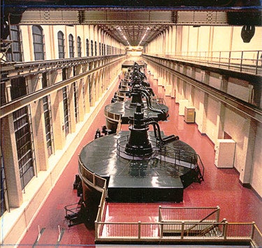

7. An even dozen. The Safe Harbor plant has 12 units with a total installed capacity of 417 MW. Courtesy: Safe Harbor Water Power Corp.
