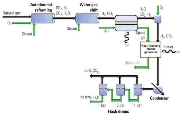

The process, which uses natural gas and solid oxide fuel cells at high electrical efficiency (74% HHV), uses a steam reformer heat-integrated with the fuel cells to provide the heat necessary for reforming (Figure 6). The fuel cells are powered with hydrogen and avoid carbon deposition issues. MIT postdoctoral associate Thomas Adams and Paul I. Barton, the Lammot du Pont Professor of Chemical Engineering, say in a recent Journal of Power Sources article that 100% of carbon capture is achieved downstream of the fuel cells with very little energy penalty using a multi-stage flash cascade process, where high-purity water is produced as a side product.
6.     A natural gas/fuel cell hybrid. A power generation system proposed by MIT researchers, which uses a novel configuration of natural gas and high electrical efficiency solid oxide fuel cells, promises near-zero carbon emissions. The process contains a steam reformer integrated with the fuel cells to provide the heat necessary for reforming. Alternative reforming techniques such as carbon reforming, autothermal reforming, and partial oxidation are also considered. The capital and energy costs of the proposed process are considered to determine the levelized cost of electricity, which is low when compared with similar carbon capture–enabled processes. Courtesy: MIT
