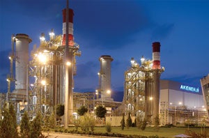

GE Energy's latest "first" is in Turkey, where the Frame 6C gas turbine-generator—a younger cousin of the popular Frame 6B—has made its commercial debut. The turnkey 130-MW combined-cycle plant, called the GE206C, comprises two 40-MW Frame 6Cs, one GE steam turbine-generator, two heat-recovery steam generators, and a distributed control system. The gas-fired plant (Figure 1), in Kemalpasa-Izmir, is owned and operated by Istanbul-based Akenerji, one of Turkey's leading independent power producers.
Courtesy: GE Energy
1. Pioneering plant. This 130-MW combined-cycle power plant in Kemalpasa-Izmir, Turkey, is the first deployment of GE's new Frame 6C gas turbine.
