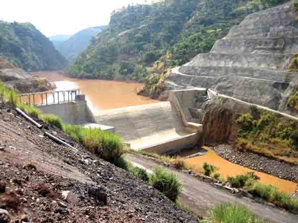

Gilgel Gibe II — currently the largest hydro project in Ethiopia — took five years and €370 million to complete (€220 million covered by the Italian government), according to the Ethiopian Electric Power Corp. Built by Italian construction firm Salini Costruttori, the plant was designed by Studio Pietrangeli, with engineering supervision by ELC-Electroconsult. It features four 105-MW Pelton units, a 26-kilometer machine-bored tunnel, penstocks, and a surface powerhouse (Figure 5).
5.     Abyssinian giant. The 420-MW Gilgel Gibe II hydropower plant was inaugurated in Ethiopia in mid-January. Featuring four 105-MW Pelton units, a 26-kilometer machine-bored tunnel, penstocks, and a surface powerhouse, the project is currently the largest hydro plant in Ethiopia—but not for long. The third phase of the project on the Omo River, Gilgel Gibe III, is currently under construction. When complete, that project is expected to generate 1,870 MW for Ethiopia. That could alleviate the nation’s chronic power shortages and possibly supply power to the rest of power-starved East Africa. Courtesy: ELC-Electroconsult
