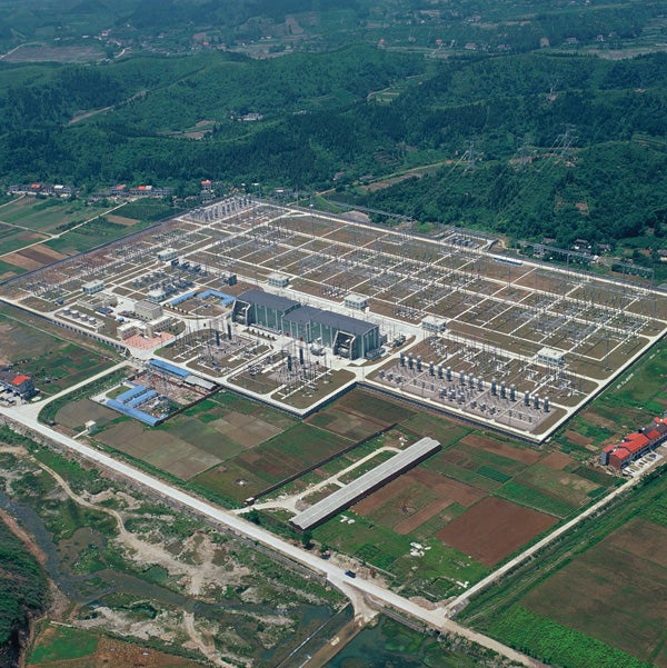

1. Somewhere along the line. China, which in 2008 had already completed one 1,000-kV UHV AC circuit, in July put into operation the 2,000-km, 800-kV Xiangjiaba-Shanghai link. Two other 800-kV DC circuits are under construction. The Longquan high-voltage direct current converter station shown here is similar to those used at these massive hydropower transmission projects in China. Courtesy: ABB
