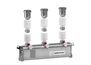

Southern States LLC has launched a new line of power switching products that replace sulfur hexafluoride (SF6)—one of the most potent greenhouse gases known—with a natural-origin blend of CO2 and O2. The Hampton, Georgia–based manufacturer says its O2rigen technology delivers a global warming potential (GWP) of less than 1, compared to SF6’s GWP of approximately 23,500.
The announcement comes as utilities face mounting pressure to phase out SF6 from their electrical infrastructure. California’s Air Resources Board (CARB) has implemented strict regulations on the gas, and several other states and countries are following suit. SF6 has been widely used in high-voltage switchgear and other electrical equipment for decades due to its excellent insulating properties, but its atmospheric persistence—it can remain in the atmosphere for more than 3,000 years—has made it a target for climate regulators.
“We didn’t create a solution that simply complies with mandates to eliminate SF6 gases,” said John Paserba, president and CEO of Southern States. “We created a solution that simultaneously protects our environment and our power supply for the long term.”
Southern States is initially offering two products under the O2rigen brand. The LLS (Load and Line Switcher) – O2rigen features what the company calls a breakthrough single-gap, natural-origin gas puffer interrupter for load-break applications. The Cap38 – O2rigen is designed specifically for capacitor bank switching, offering restrike-free operation and long service life.
Both products are extensions of existing field-proven Southern States designs, which the company says reduces technological risk while delivering the environmental benefits of the new gas technology.
One advantage Southern States emphasizes is supply chain simplicity. Unlike some SF6 alternatives that rely on proprietary gas blends with restricted availability, CO2 and O2 are readily available throughout North America with no purchase restrictions. Products are delivered factory-sealed and ready for installation, eliminating the need for on-site gas filling or specialized reclamation equipment.
