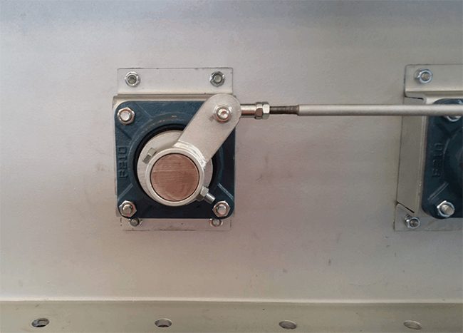

Take the case of the dampers that control the flow of preheated air into the turbine’s combustion processes (Figure 1). Some power plants have experienced difficulties when attempting to open these dampers. As a result, hot air quickly dries out the lubricant in the steel damper bearings. This causes them to seize. The best solution to this problem is to replace the original steel bearings with material that can withstand the heat.
1. Four-bolt, self-aligning, cast iron flange blocks with Graphalloy inserts were implemented to resolve bearing failure issues that stalled combustion processes at an Italian facility. Courtesy: Graphite Metallizing Corp.
At a refinery project in Italy, Graphalloy bearings from Graphite Metallizing Corp. of Yonkers, New York, were installed to eliminate continual maintenance issues with the steel bearings in the dampers. These new damper bearings have since run for several years without causing the refinery’s power plant any further issues.

At the refinery in Italy, dampers play a vital role in the power control units that run as part of the refining process. The dampers are there to open and close the dry air and flue gas flow to the treatment plants. To accomplish this, they must be able to withstand loads of 440 pound-feet of torque at a speed of 25 revolutions per minute and at temperatures up to 400C (750F). These dampers were in continuous use—every 10 minutes, they rotated 90 degrees as part of airflow control.
Unfortunately, temperatures were commonly at the upper range of the process and sometimes exceeded it. As a result, the SKF ball bearings operating within the dampers were subjected to excessive heat levels that went beyond their design parameters. This resulted in bearing failures.
Maintenance personnel at the refinery often had to replace these bearings. As well as adding to the maintenance and equipment procurement budgets, outages due to damper failures proved costly in terms of revenue by interrupting refinery operations. Based on experience with similar issues, Dama Energy Services contacted an engineer at Graphite Metallizing Corp. to devise the best bearing solution to solve these damper problems.
“After analyzing the process technical specifications, I contacted Graphalloy to request bearings with temperature and rotation characteristics that would meet the project needs,” said Alfredo Mariotti, engineer and technical director at Dama.
The solution in this case turned out to be Graphalloy Type 845 self-aligning flange block assemblies, with copper-grade inserts (Figure 2). Dimensionally interchangeable with the SKF ball bearings, these new components allowed the damper paddles the movement they needed in an environment and at temperatures where the existing ball bearings were prone to failure.

Dama Energy Services installed the new damper components at the refinery using the new materials. After a couple of months of trouble-free operation, more of these damper assemblies were ordered to be installed more broadly across the facility, reported Mariotti.
