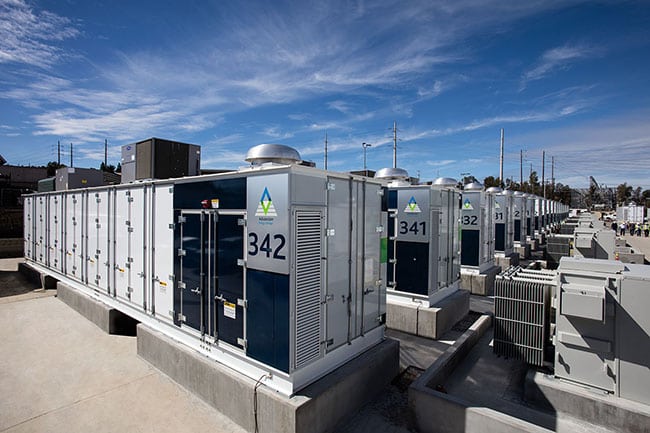

Another reason for this soaring growth is that energy storage is now being incorporated broadly into utility planning and power system planning across the world, said John Zahurancik, who served as president for AES Energy Storage between 2015 and 2017, and is now chief operating officer of Fluence Energy, a partnership between AES Corp. and Siemens that provides a technology and service package to the power sector. Zahurancik told POWER in January: “If you look at the resource planning guides that are coming out of major utilities, and if you look at the independent system operator areas and the ways that they’ve incorporated rules changes, they’ve incorporated energy storage.”
SGD&E's 30-MW, 120-MWh system unveiled in February 2017 in Escondido, California, was supplied by AES Energy Storage. The facility was part of an expedited response by the state and the California Public Utilities Commission to the loss of the Aliso Canyon natural gas storage facility north of Los Angeles in 2016. Courtesy: AES Energy Storage
SGD&E’s 30-MW, 120-MWh system unveiled in February 2017 in Escondido, California, was supplied by AES Energy Storage. The facility was part of an expedited response by the state and the California Public Utilities Commission to the loss of the Aliso Canyon natural gas storage facility north of Los Angeles in 2016. Courtesy: AES Energy Storage
