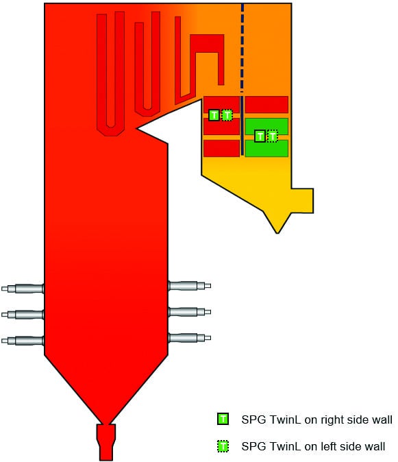

Explosion Power GmbH was tasked with mitigating unfavorable conditions upstream of the SCR in a 24-meter-wide backpass chamber. GHECO-One installed four SPG TwinL units, two per side (Figure 2), to assist the sootblowing system, keeping the economizer clean in order to pick up exhaust heat, and improve and stabilize boiler efficiency. Importantly, this protects the sensitive SCR element from excessive heat and accelerated decay. The backpass mainly accumulates small ash particles that are sufficiently removed by the four TwinLs.
2. GHECO-One installed four SPG TwinL shock pulse generator units—two per side—in the 24-meter-wide backpass area shown on this schematic. The units assist the sootblowing system, keeping the economizer clean and protecting the selective catalytic reduction system from excessive heat and accelerated decay. Courtesy: Explosion Power GmbH
