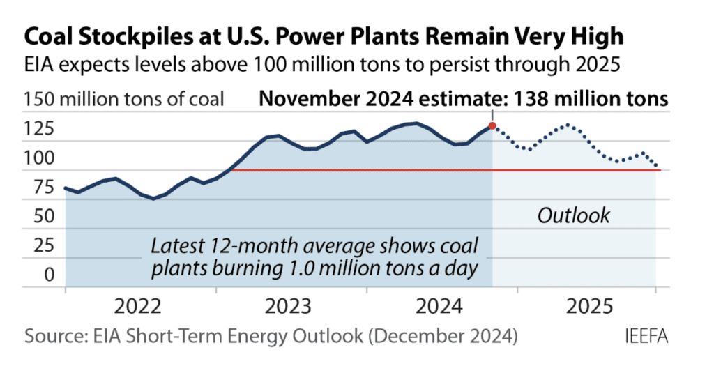

A new report from the Institute for Energy Economics and Financial Analysis (IEEFA) says U.S. coal-fired power plants have as much as $6.5 billion of unused coal inventory, based on the latest figures on fuel stockpiles from the U.S. Energy Information Administration (EIA).
The IEEFA on Dec. 16 said the nation’s coal-fired power stations today are burning only about 1 million tons of coal daily, half the amount the industry was using in 2015. The “days of burn,” or the amount of coal on hand divided by the amount being burned each day, for coal-fired power plants at present is about four months on average, according to the IEEFA. The group said most operators would usually keep a 50- to 60-day supply on hand. Government data shows coal-fired generation accounts for about 16% of U.S. electricity production, about half the share it held a decade ago.
The EIA said U.S. coal-fired power plants had about 138 million tons of coal on hand at the end of November. The IEEFA based its analysis on a $47.22 per ton average cost of coal delivered to U.S. power plants (including transportation) from January through September of this year.

Seth Feaster and Dennis Wamsted, authors of the IEEFA report, wrote, “No power producer wants that much money idly sitting around. But it has become much harder to burn that coal without losing money. Low gas prices, as well as increased solar and wind generation, have made coal-fired electricity less and less competitive.
“Periods with high electricity prices during summer heat waves and winter cold snaps also have become fewer and farther apart. As a result, U.S. coal plants now collectively burn just 1 million tons a day, half as much as in 2015, based on the 12-month average through September. At that rate, it would take power producers more than 4 months to use up all the coal sitting around.”
The IEEFA report said that deliveries of coal to U.S. power plants “have already been falling steadily for more than 15 years, from more than 80 million tons a month in 2008 to about 30 million a month in 2024. With huge stockpiles at power plants that utilities need to use, that trend looks set to continue in 2025, and could lead to some months with less than 20 million tons in deliveries.”

The EIA in the December report said it expects 25 GW of solar power will enter service next year, along with 9 GW of wind energy capacity. The agency in its report said the “combination of a modest increase in consumption from operating coal plants and a decline in coal production will reduce coal inventories held by power plants from 131 MMst [million short tons] at the end of this year to 100 MMst by the end of 2025.”
