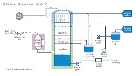

After successful pilot testing funded and hosted by FirstEnergy, in February 2004, Powerspan installed a 50-MW (equivalent) commercial demonstration unit (CDU) of its Electro-Catalytic Oxidation (ECO) process (Figure 3) at the Burger plant and began testing it as an integrated system. The CDU worked on an 110,000-scfm (standard cubic ft/min) gas slipstream from the ductwork of Unit 4 or 5, downstream of the plant’s existing electrostatic precipitator (Figure 4). The treated gas was returned to the ductwork just upstream of the stack.
3. Proof of performance. In 2005 the ECO commercial demonstration unit was operated continuously for six months to confirm the design and reliability of the system. Although the demo ended two years ago, the ECO unit remains in service. Source: Powerspan
4. Hooked on gas. A 50-MW (equivalent) gas stream was taken from the stack gas, treated in the ECO system, and then returned to the ductwork just ahead of the stack. Source: Powerspan
A 180-day reliability run of the CDU that ended in September 2005 demonstrated that ECO meets all current performance requirements for NOx, SO2, and particulate control, and can remove 85% of the Hg in flue gas to boot. The table summarizes the results of the reliability run, during which the CDU was more than 98% available.

Some might argue that the results of testing a 50-MW CDU are not representative of the performance of a full-size ECO process retrofitted to a plant 10 times larger. But because the system’s dielectric barrier discharge reactor and wet ESP are modular, and their performance is based on gas volumetric flow and the reaction chemistry, the ECO process is eminently scalable to any size required. Although the system’s ammonia scrubber is not modular, the technology for scaling that part of the process is well understood.

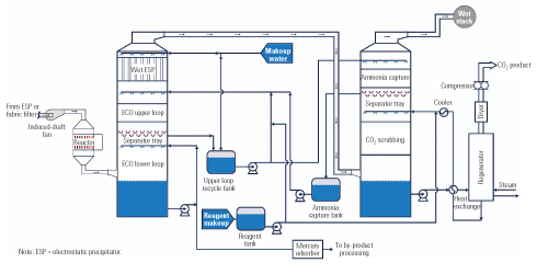

The ECO process is just as applicable to greenfield plants as to existing ones. This June, American Municipal Power-Ohio (AMP-Ohio) committed to use the process at its proposed AMP Generating Station, a 1,000-MW coal-fired project in Meigs County, Ohio. The selection was driven by the promise of CO2 capture by the recently announced ECO2 system, which is being designed to integrate easily with the ECO process (see box). Naturally, AMP-Ohio will be a partner in a planned program to test a pilot version of ECO2 at the Burger Plant.
