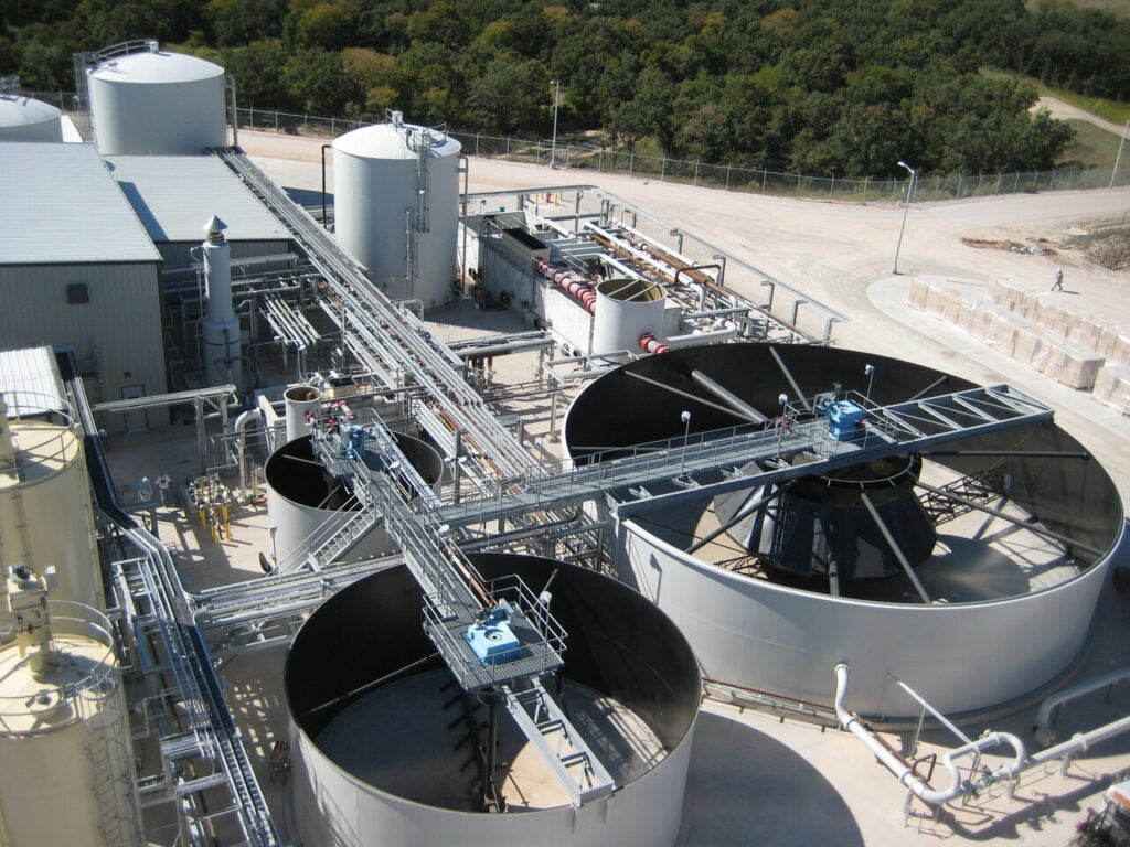

1. A service engineer and customer walk through a plant. Courtesy: Nalco Water
