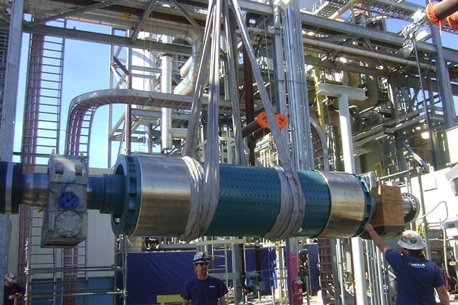

As part of its work, MD&A’s gas turbine maintenance team both opened and closed the gas turbine. In addition, the team removed the original rotor and shipped it off-site for refurbishment and high-speed balance.
As well, MD&A removed the generator field and sent it to our St. Louis facility for a complete test and inspection, and high-speed balance before being returned to site.

  • Generator Field Rings Off Inspection, test & inspect, and high-speed balance
  • Gas Turbine rotor high-speed balance
