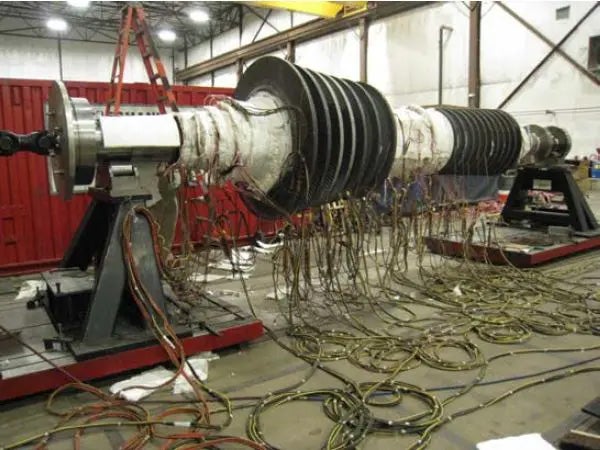

Bowed HIP and Clearance Control
The D11 rotor geometry, as it is long and slender, significantly increases the risk of a bowed rotor condition. Being prepared for these issues when they arise is critical to the serviceability of these machines.
During a site inspection, MD&A technicians evaluate the specified clearances, the levels of distortion in the casing, rotor, and diaphragms, and all other components. For the casing and diaphragms, MD&A alignment engineers can perform a realignment to re-establish required clearances and for improved efficiency.
Traditional bowed rotor repair is a shop process performed by MD&A’s Turbine-Generator Repair Facility in St. Louis, MO USA. If needed, straightening can be performed on-site with vertical or horizontal thermal straightening and stress relief. When required, high-speed balance can be performed in our state-of-the-art balance facility.

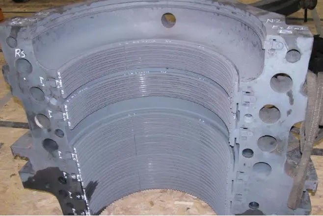

Diaphragm Dishing
Diaphragm dishing can occur due to high operating temperatures, insufficient main weld depths, thermal events or poor operating conditions. Continued and unaddressed dishing can lead to catastrophic failure and long duration forced outages.
MD&A offers specialized diaphragm dishing repair services ranging from diaphragm inserts for upstream displacement, offset packing segments, restoration of diaphragm fabrication welds including increasing main weld depths, diaphragm stiffness improvements when possible, and all required machining.  MD&A also offers new custom–engineered diaphragms, provided sufficient intellectual property (IP) can be obtained to support it.

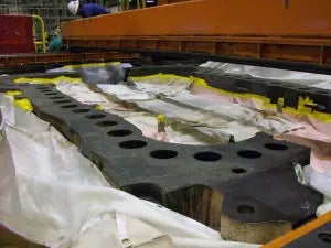

Horizontal Joint Leakage
The D11 lower HP/IP casing is long and slender, supported on the ends with the highest temperatures in the mid-span section.  Over time the casing sags, with the lower half experiencing higher temperature transients during startups and high enough steady state midsection steam temperatures to permanently yield portions of the casing.  The result can be steam leaks from inside to atmosphere and eventual steam cutting off the top to bottom flange, entering the insulation. The impacts are efficiency (heat loss), operability, and safety.
The solution requires localized repairs and re-machining to correct both the steam cutting and the casing sag.
MD&A offers laser scanning equipment to determine the amount of distortion as compared to the original joint plane. Following weld buildup of the horizontal joint, a laser-guided mill blends the repaired section to the original plane. MD&A’s skilled technicians have been performing this on-site work successfully for more than two decades on a variety of OEMs and steam turbine models.
A related issue is mid-span outer shell creep and associated axial clearance shift from the N-2 downstream as rotor length remains constant. Offset packing rings and modified diaphragm seal faces are two of several solutions offered by MD&A.

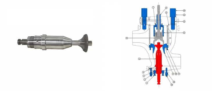

Combined Cycle Valve Drop-in
This drop-in valve removes a detailed inspection from critical path saving outage duration. It enables shop inspection of removed assemblies, including reuse/ repair/ replace decisions and purchase of valve parts (i.e. stems, bushings and disks) off critical path for outage. This is ideal for CI \ HGP Inspection cycles.
It is available for D11 and A10 steam turbines and other structured valve configurations.
“Hot swap” or Spare Sub-assembly Offerings:
• Control Valve/ Intercept valve in gray
• Stop Valve/ Reheat stop valve in red
• Blue are optional spare parts
MD&A Upgraded Stems/Seat/ Bushing
The D11/A10 MSCV (Main Steam Control Valve) Nickel Cladded Stem and Hardened Seat Upgrade reduces erosion rates and prevents steam leakage. This valve controls the flow of high-pressure steam from the boiler/HRSG into the steam turbine. It is interchangeable with existing components.
This upgrade has reduced steam erosion by 80% thereby enabling extended maintenance intervals.
The D11/A10 MSCV and CRV (Combined Reheat Valve) Stellite Lined Bushing Upgrade mitigates oxide formation growth rates. It reduces the opportunity for stem binding and maintains stem-to-bushing clearances. Also reduces wear which enables extended maintenance intervals.

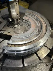

Combined Cycle Valve Casing Solution
Developed to address low cycle fatigue cracking in the OEM’s Combined Cycle D11/A10 fleet, this MSCV casing replacement can be provided standalone or with our valve internal upgrades options.
D11/A10 7″ and 9″ MSCV Casing features a direct, in-kind replacement with OEM material. The casing has martensitic steel upgrade option to increase toughness and creep strength. The valve casing and critical components are inspected using Non-Destructive Examination (NDE) methods to identify defects without damaging the parts, which increases turbine reliability and safety.
