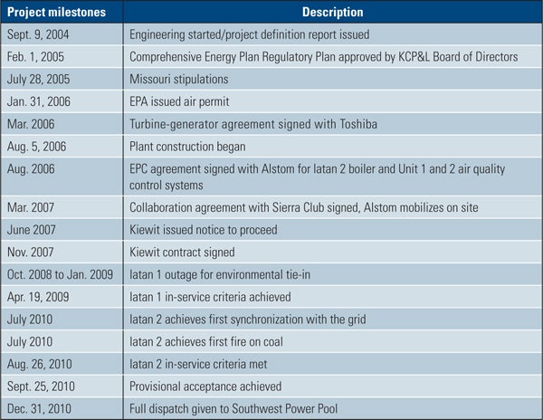

Table 1. Key milestones for the Iatan 2 project. Iatan 2, erected over a five-year period, was one of the largest and most complex construction projects in Missouri and KCP&L history. Source: KCP&L

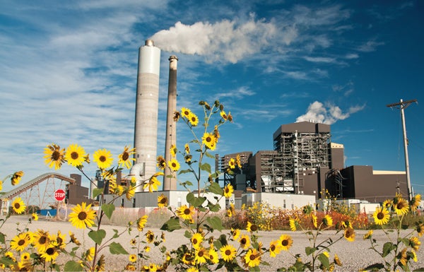

1. Latest and greatest. The Iatan Generating Station is located on the banks of the Missouri River in western Missouri. Commercial operation of Iatan 2 in December 2010 added 850 MW to the approximately 700 MW produced by Iatan 1. Iatan 2 was the first new baseload power generator installed by KCP&L in nearly 30 years.
