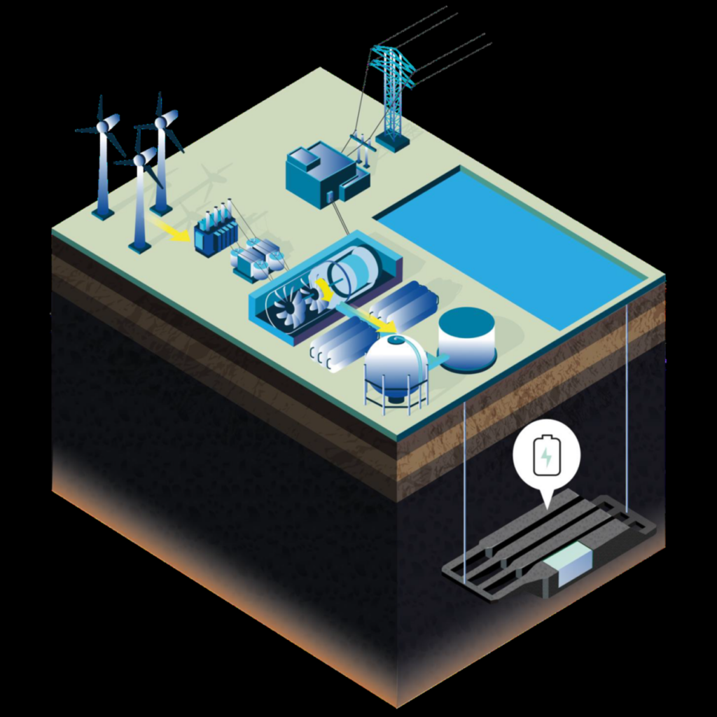

2. Hydrostor’s Advanced-CAES approach uses pressurized air and water storage to eliminate the need for a gas turbine to generate power. Courtesy: Hydrostor
“Traditional CAES is scalable but produces carbon emissions as it uses natural gas combustion to generate power from compressed air,” said Reusser. “Advanced CAES systems can provide efficiency rates as high as 80% in some of the latest applications.” CAES variants include the following:
  • Canadian company Hydrostor is well-advanced along the approval/permitting pipeline to build what it calls an Advanced-CAES facility (Figure 2) in Rosamond, California. Known as the Willow Rock Energy Storage Center, it will provide 500 MW of power using many of the traditional elements of CAES, but it stores compressed air in a cavern up to 2,000-feet below ground surface. That air is used to displace water from the underground cavern, forcing the water up to a spill pond on the surface. To generate power, air is released from the cavern, heated in hot water tanks, and is used to power turbines.
