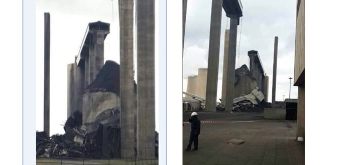

Eskom’s 3.6-GW coal-fired Matla Power Station’s six 600-MW units in Mpumalanga near Kriel, South Africa, were built between 1979 and 1983. The plant features a concrete boiler house structure, an innovative choice driven by a global steel shortage during construction. Coal is primarily supplied via conveyor from the nearby Exxaro colliery, with supplemental trucked coal. The station has undergone partial upgrades but missed a critical mid-life rehabilitation. Today, Matla remains vital to South Africa's power grid despite operational and maintenance challenges. Courtesy: Eskom
Eskom’s 3.6-GW coal-fired Matla Power Station’s six 600-MW units in Mpumalanga near Kriel, South Africa, were built between 1979 and 1983. The plant features a concrete boiler house structure, an innovative choice driven by a global steel shortage during construction. Coal is primarily supplied via conveyor from the nearby Exxaro colliery, with supplemental trucked coal. The station has undergone partial upgrades but missed a critical mid-life rehabilitation. Today, Matla remains vital to South Africa’s power grid despite operational and maintenance challenges. Courtesy: Eskom
