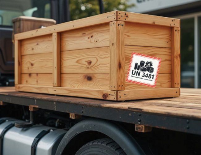

1. This battery, placed in a regulatory-compliant container, will be transported by truck. Courtesy: Bluewater Battery Logistics
The U.S. Hazardous Materials Regulations (HMR) and international regulations are complex and difficult to navigate particularly for those not using them regularly. Your best resource is to work with professionals that are knowledgeable and have extensive experience applying the regulatory requirements while understanding the best practices to enhance safety while reducing unnecessary expenses. For example, even if your batteries are classified correctly, and have all the required labels, you still need to make sure your shipper is trained and certified for hazmat transportation. Additionally, there are a number of innovative packaging alternatives (Figure 1), each having advantages and disadvantages, which the professionals can recommend. The complexity and the high risks involved makes transportation companies with a hazmat focus join forces with battery logistics specialists and their hazmat legal partners to make sure the battery shipments are safe and compliant.

Labeling is equally important. Every package must display the correct hazardous materials labels (Figure 3), along with the appropriate U.N. markings. This isn’t just about compliance; it’s about communicating the risks to people handling the shipment, including emergency responders. Accurate shipping papers are crucial too, detailing the contents, handling instructions, and emergency contact information. This ensures that if something goes awry, everyone knows how to respond.
3. These lithium batteries are being transported in boxes that clearly label the contents to alert shippers about the materials inside. Courtesy: Bluewater Battery Logistics
