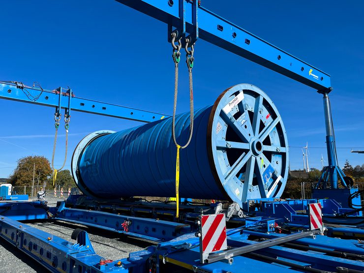

1. Loaded and secured cable drum on a short self-driving vehicle. Courtesy: deugro

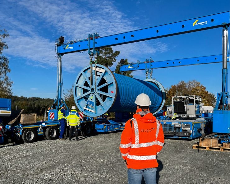

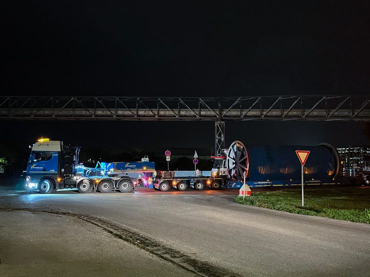

2. Start of night transportation at the Port of Kelheim. Courtesy: deugro

The biggest challenges are the cylindrical shape and the weight of the cable drums (Figures 3 and 4), as well as Bavaria’s hilly landscape, varying topography, and infrastructure. Therefore, to ensure the safe transportation of the cable drums, a customized solution enabling the safe load securing and efficient unspooling operations simultaneously after arrival was developed. A unique fact of the deliveries is that the cable drum will not be discharged but stay on the transport configuration during the unspooling of the cable.

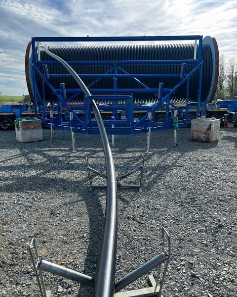

“Each cable drum is positioned on four rollers on which it can rotate evenly during unspooling [Figures 5 and 6]. This purpose-built unspooling device is flexible and can be used for different transport configurations for this project. Because the steel of the cable drums is directly loaded onto the steel of the unspooling device, less friction can be considered for the calculation of the required load securing. This big challenge has been solved by developing an appropriate load securing consisting of chains and a tailor-made, adjustable form fit designed in collaboration with our partners,” said Junker.
5. Unspooling operations at the destination. Courtesy: deugro
6. Unspooling operations at the destination. Courtesy: deugro
Due to Bavaria’s hilly landscape, and the strongly varying topography and infrastructure, for the majority of the route, extensive traffic management measures—including civil works along the route to extend and strengthen streets and turns, to pass rotaries and deal with height obstacles like lifting electricity lines, to turn or dismantle traffic lights and bypass bridges—must be arranged.
Another specialty of the project is that the drums need to be transloaded on their way to the job sites onto self-propelled PSTs or low-bed trailers, which are shorter but, with a transport height of approximately 5.40 meters, much higher than vessel girder bridges. These are longer but lower and therefore suitable for highway transport to transit below overpasses.
The reason for the transloading is the length of the complete transport configuration of about 40 meters, which hinders the configuration from passing through the narrow streets of small Bavarian villages. As a transloading movement is needed for approximately 50% of the cable drums on their way to the individual construction sites (Figures 7 and 8), including their return delivery—still weighing approximately 10 metric tons—to the two storage yards, it is estimated that the entire project will involve more than 2,400 individual heavy haul transports each requiring special permits and escorts.

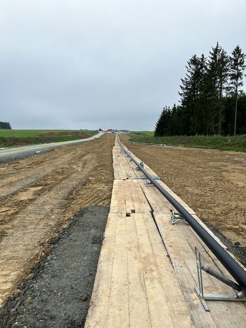

7. Cable-laying operations. Courtesy: deugro
8. Cable-laying operations, with the cable drum in the background. Courtesy: deugro
