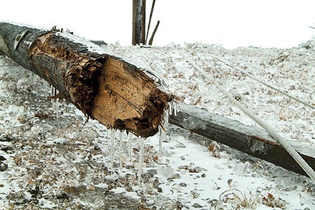

1. Cold snap. End-of-the-year ice and wind storms devastated Nebraska Public Power District’s transmission network, isolating its largest power plant. Courtesy: Nebraska Public Power District
"The storm basically cut our statewide transmission system in half," said Ron Asche, CEO of NPPD. "That damage is visible to anyone driving past the downed power lines. What many don’t realize is that we also had to reduce [generation] at our largest power plant. We have had to replace that power by running higher-cost plants and buying electricity on the spot market. This may add millions of dollars to our operating costs for 2007."

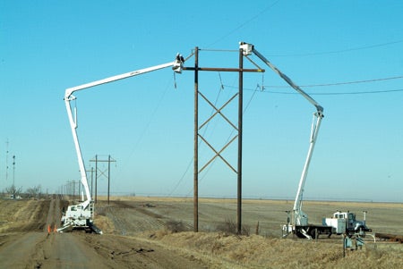

As temperatures rose after the ice storm and service restoration crews began to assess the damage and get power flowing again (Figure 2), Nebraska was struck by a windstorm with gusts topping 50 mph. Crews worked through the dangerous conditions to restore power as quickly as they could, and much—but not all—of the statewide power system was working again within about a week.
2. Adding insult to injury. NPPD crews had to face high winds as they worked to rebuild the statewide transmission and distribution system. Courtesy: Nebraska Public Power District

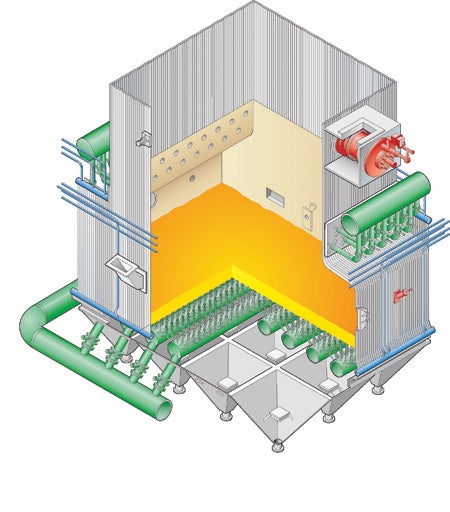

NZ Legacy said that the plant will be powered by a Babcock & Wilcox bubbling fluidized-bed boiler (Figure 3) that has been specifically designed to accommodate the waste fuel specs. The developer explained that the plant’s reuse of components (including conveyors and screw presses) from an idled paper facility in Houston will improve its economics.
3. B&W bubbler. The open bottom of the lower furnace of Babcock & Wilcox bubbling fluidized-bed boilers offers a clear path that eliminates debris without creating dead zones in the bed, says the company. Courtesy: Babcock & Wilcox
