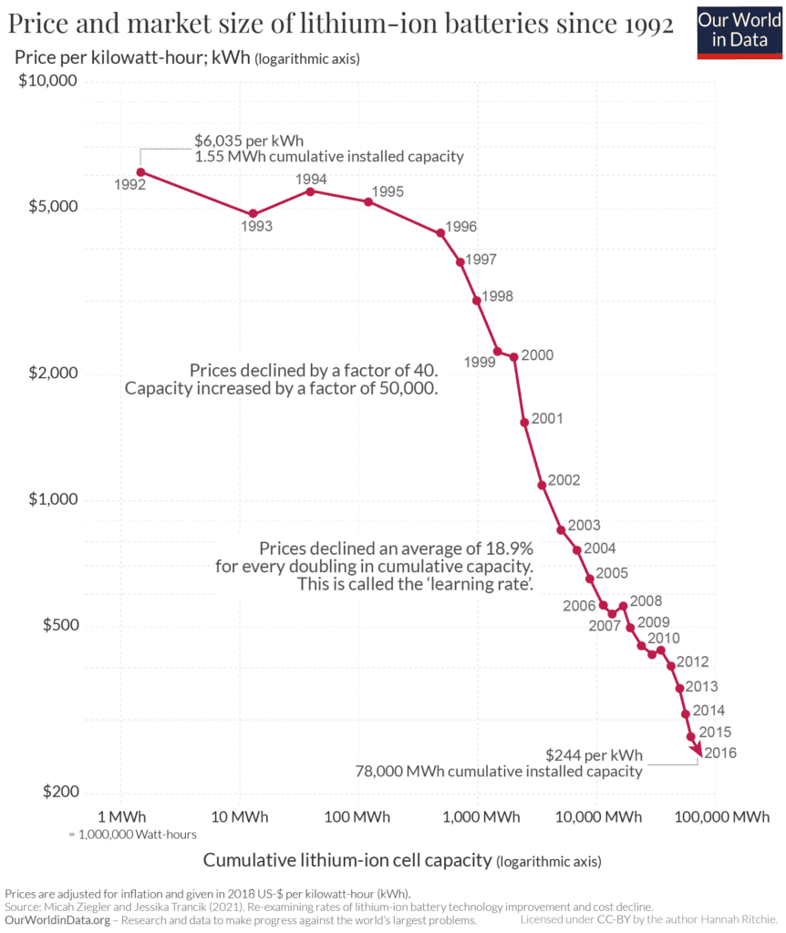

The story of “exponential technologies,” such as PV solar, batteries, and power electronics, is the story of continuous global innovation and steep learning curves (Figure 1) that have been sustained over decades and are coupled with exponential increases in deployment, and a massive and expanding global market that allows growth to continue. Wind, on the other hand, is not an exponential technology, but has seen prices decline to well below grid parity, driven mainly by an increase in the size and ratings of wind turbines (some now more than 15 MW). More recently, however, wind LCOE has stabilized—although the fact that it is still below conventional fossil generation implies that wind will likely keep gaining market share in the near term, especially because of higher capacity factors.
Figure 1. This graph demonstrates the steep sustained learning rates for lithium-ion batteries. PV solar technology also exhibited a rapidly falling cost curve over the past couple of decades. Courtesy: Hannah Ritchie (2021) – “The price of batteries has declined by 97% in the last three decades” published online at OurWorldInData.org. Retrieved from: https://ourworldindata.org/battery-price-decline [Online Resource]
On the other hand, prices for PV solar and batteries continue to decline with learning rates of 23% to 25% and no end in sight. This is akin to what we have seen in semiconductor and integrated circuit technologies, and is now driving innovation, investment, and disruption across the globe in the energy sector. Economics suggest that the energy transition is now unstoppable, but whether the path forward will be smooth and economical, or messy and expensive, depends on our actions and policies over the next few years. These actions will also determine if we will be able to meet societal goals focused on energy abundance, decarbonization, sustainability, and climate change, or if we will, in the near term, plunge into a more dystopian world where energy is more expensive, less reliable, less equitable, causes more emissions, and where we have lost the climate battle as well.
