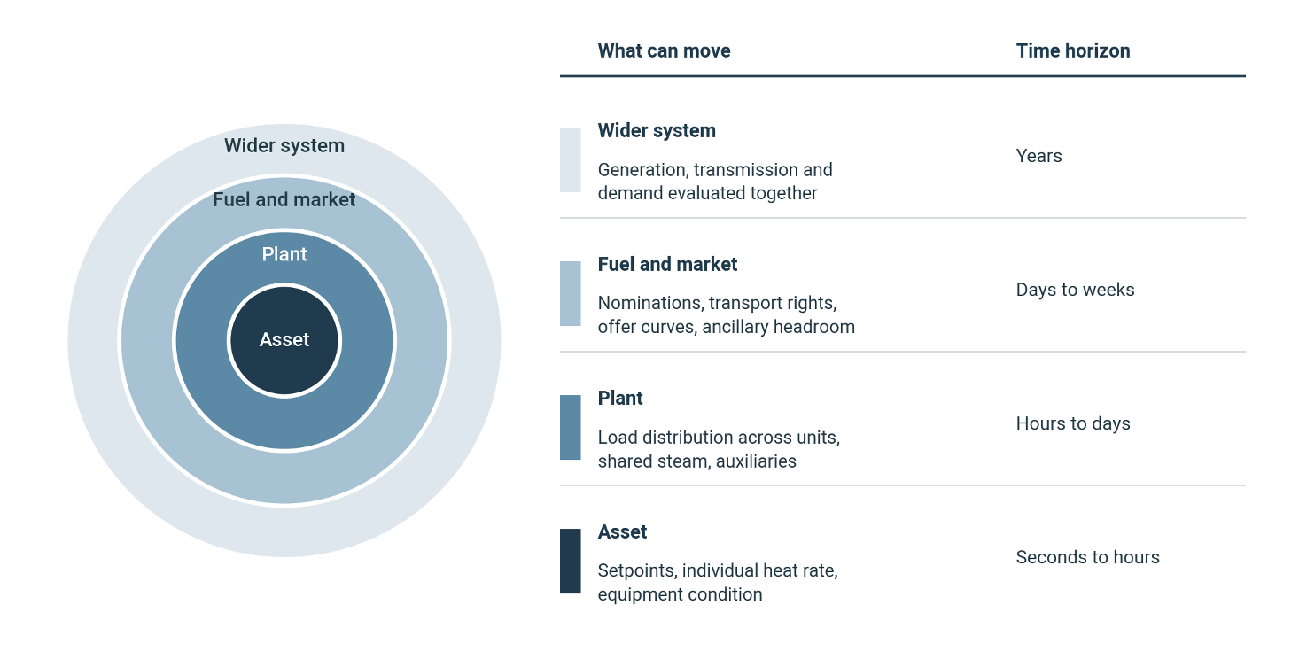

Where the Boundary Should Move, and Where it Should Not
So is the answer to optimize everything together? Not quite. In practice, that approach is not always feasible nor necessary. Black & Veatch projects have demonstrated that the greatest opportunities for improvement exist where systems are most tightly interconnected, not necessarily where individual assets have the most room for improvement.
Some assets and systems are only weakly coupled. In those cases, local optimization can produce essentially the same result as a larger integrated model. Engineers should identify where interactions are strong enough to warrant expanding the boundaries. This requires an intimate understanding of both the physical system and the business.
Four optimization boundaries around the same decision, each introducing additional interactions, constraints, and decision levers. Source: Black & Veatch

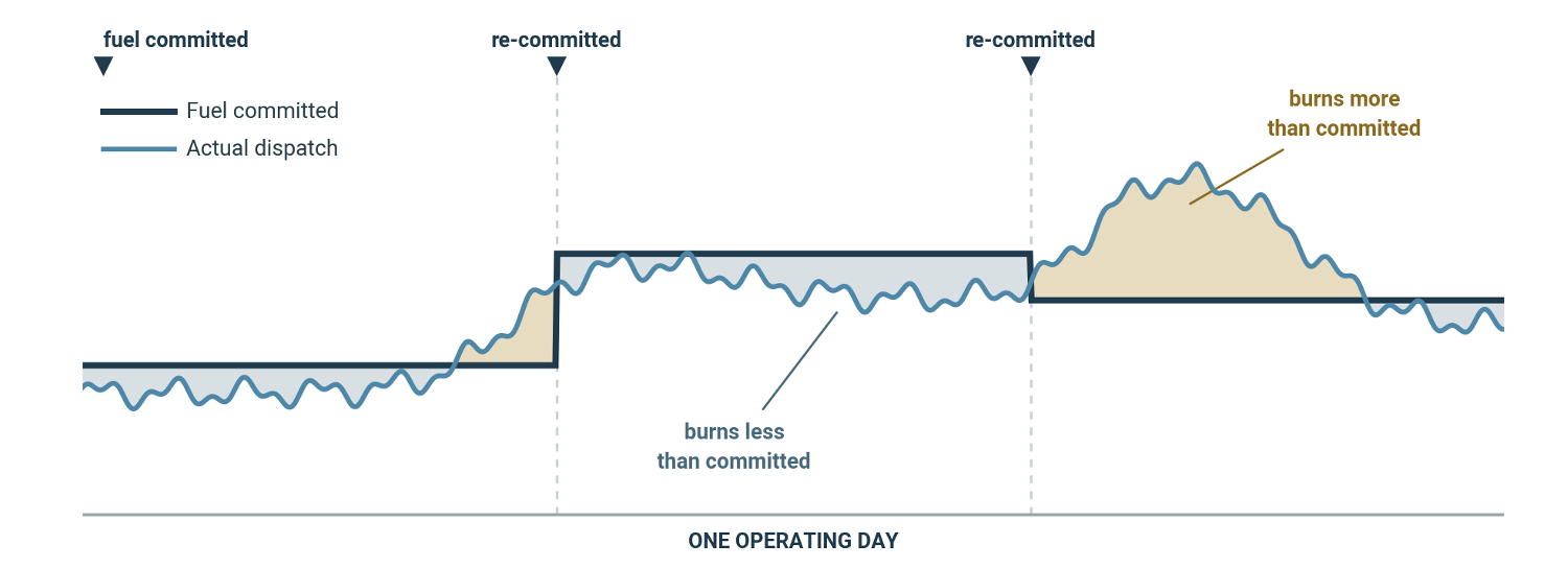

Committing Fuel Before Dispatch is Known
For a gas-fired plant, one important boundary condition sits upstream of the fence, where resource commitments are made before actual operating needs are known. A plant may commit fuel for the next operating period before there is certainty about how hard the plant will run. That decision can influence cost, flexibility, and the plant’s ability to respond when actual dispatch differs from the plan.
The decision clocks do not always match. Fuel may be arranged in discrete planning windows, while plant output can change throughout the day. When fuel supply, plant operations, and scheduling use different assumptions, the result can be excess cost, reduced flexibility, or exposure during stressed conditions.
The same idea appears in other forms of generation. Hydroelectric facilities decide when to use water stored in reservoirs; battery storage operators decide when to charge and discharge; while wind and solar plants depend on forecasts rather than fuel inventories. In every case, operators make momentary optimization decisions without considering how the operating conditions may change tomorrow.
An integrated model, on the other hand, can evaluate such commitments across a range of possible operating outcomes rather than relying on one expected base case. This helps the plant balance cost, availability, and flexibility without requiring a full-fledged market-trading exercise.
Resource commitments are made before actual operating conditions are known. The gap between commitment and dispatch creates operational and economic exposure. (Shapes are directional.) Source: Black & Veatch
