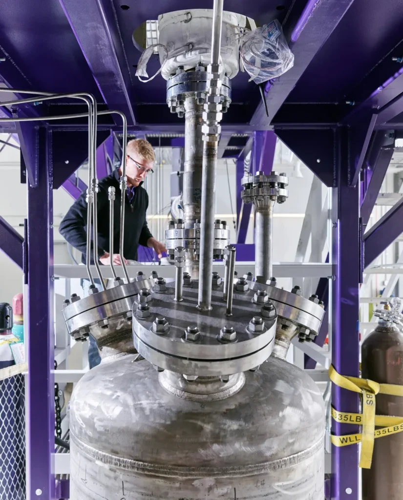

The MSRR, a “utilization facility” dedicated to accelerating the development and deployment of molten salt reactor systems (MSR), will mark the first deployment of Natura’s MSR-1. The low-power reactor (of less than 1 MWth) has a “single-region, graphite-moderated core, loop-type, thermal-spectrum reactor with a fluoride-based fuel salt flowing through 316H stainless steel fuel circuit components,” ACU’s NEXT Lab says in its application.
The MSRR's reactor loop circulates fuel salt—a mixture of lithium fluoride (LiF), beryllium difluoride (BeF₂), and uranium tetrafluoride (UF₄)—through the reactor vessel, heat exchanger, and back, transferring thermal energy to the atmosphere via a secondary coolant loop. UF₄ is added to the fuel salt for refueling. Safety is managed by a passive reactor protection system (RPS), which drains the fuel salt into a subcritical tank for cooling. Control rods regulate reactivity during normal operations. Source: ACU/NRC
The MSRR’s reactor loop circulates fuel salt—a mixture of lithium fluoride (LiF), beryllium difluoride (BeF), and uranium tetrafluoride (UF)—through the reactor vessel, heat exchanger, and back, transferring thermal energy to the atmosphere via a secondary coolant loop. UF is added to the fuel salt for refueling. Safety is managed by a passive reactor protection system (RPS), which drains the fuel salt into a subcritical tank for cooling. Control rods regulate reactivity during normal operations. Source: ACU/NRC
“A cooling loop with flowing, fluoride-based salt is used to cool the fuel circuit and expel the heat to the atmosphere,” it explains. “The MSRR is equipped with an off-gas system that can relocate fission gases from the reactor headspaces through stainless-steel circuit components for sequestration and decay. The low-power MSRR is designed to be passively safe. It relies on intrinsic properties of molten salts and engineered safety features to ensure safe and reliable operations.”
The fuel salt, operating at a maximum temperature of 650C, will contain a mixture of lithium fluoride, beryllium difluoride, and uranium tetrafluoride (LiF-BeF2-UF4 with a molar ratio of about 67:28:5). It will use high-assay, low-enriched uranium (HALEU) with an U-235 enrichment of 19.75% and 99.99% enriched in Li-7.
MSRR salts are highly ionic, chemically stable compounds that are immune to radiolysis, the university has noted. While chemical inertness eliminates the risk of fire or explosion, molten salts offer a suitable medium for heat transfer. “The MSRR salts are stable to several hundred degrees above temperatures obtainable in the reactor and remain at low vapor pressure,” it said. “The melting point of the fuel salt is about 500C (932F), and the melting point of the coolant salt is about 460C (890F). The MSRR’s large negative temperature coefficient and reactivity that passively moderates heat production also allow for a “significant” load-following capability, it said.
