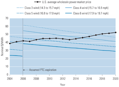

According to Platts Analytics, the biggest gainer of all renewables will be wind, which by 2016 should reach 35,640 MW of installed capacity—representing 14.1% average annual growth from the 6,364 MW installed in 2003. During 2003 and 2004, wind power development was dampened by the expiration of the Renewable Energy Production Tax Credit (PTC), explained Platts Analytics consultant Jack Ihle. "The PTC really helped drive the price of wind-produced electricity down," he said. "With the PTC, wind Classes 4, 5, and 6 are currently competitive with the U.S. average wholesale power market price [Figure 3]. Without it, only Classes 5 and 6 are competitive." In October 2004 the PTC was renewed through 2005, but the American Wind Energy Association is pushing to have it extended through 2006.
  3. The comparative economics of wind power. This graph shows that if the U.S. Renewable Energy Production Tax Credit is allowed to expire again, only wind farms at the breeziest (Class 5 and 6) sites will be able to compete with conventional generation for many years. Unlike "normal" economic graphs, which show market factors gradually changing trends, this one reflects a policy-driven disconnect, which is why we have a data "gap": On December 31, 2006, Class 5 wind will cost $30; on Jan 1, 2007, it will cost $45, assuming the PTC expires at the end of 2006. Source: Platts Analytics
