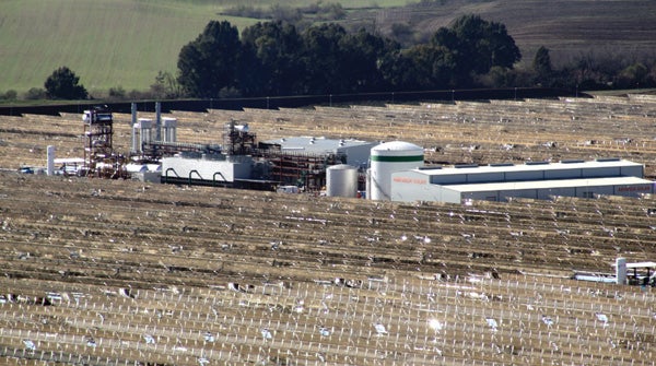

Abengoa Solar in early May began commercial operation of Solnova 1, the company’s first 50-MW parabolic trough plant. Covering 980,000 square feet with mirrors requiring an area totaling 280 acres (Figure 2), it is one of five planned concentrating solar power (CSP) plants to be built at the Solúcar Platform in Spain. All will use a technology developed by Abengoa with experience gained from a trough pilot built in 2007. Solnova 1 will also be equipped to burn natural gas if sunlight is weak.
2. A sunny place. Spanish company Abengoa Solar began commercial operation of a 50-MW parabolic trough plant at the Solúcar Platform in Andalucía. The Solnova 1 project comprises 360 collectors. Each is 150 meters long and consists of 28 mirrors. Abengoa said that the troughs were assembled using a “lean manufacturing system,” which enabled one quality collector module to be produced every 30 minutes. Solnova 1 is one of five projects planned for construction at the Solúcar Platform. Work is in progress on the Solnova 3 plant solar field. Courtesy: Abengoa Solar
