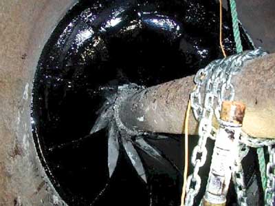

CR fluid elastomer coatings on pumps have been in service for a number of years. In one particular case, the sides and the trailing surfaces of a large impeller had suffered from cavitation and significant metal loss (Figure 8) when a CR elastomer was applied by an authorized coating applicator.
8.    Cavitation damage is severe. Close-up of damage to a pump impeller caused by cavitation. Courtesy: Belzona Inc.

  6. Apply a CR coating to the entire impeller (Figure 9).
    9.    Well-dressed impeller. A cavitation-resistant elastomer coating was applied to this pump impeller after the impeller was returned to OEM specifications. Courtesy: Belzona Inc.
