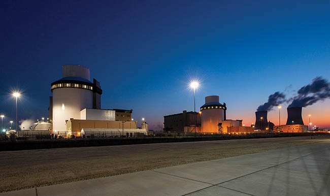

1. This image shows fuel loading activities in progress on the Vogtle Unit 4 AP1000 pressurized water reactor. Courtesy: Georgia Power Company
