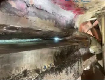

The lower half shell presented the most significant challenges. In addition to the original valve chest severe cracking, MD&A identified eight minor internal indications and four moderate external indications. While the minor indications were accepted and documented for future evaluation, the moderate ones were excavated and prepared for weld restoration.
The valve chest indications were excavated and prepped for welding.  The welding was performed utilizing a GTAW welding process for the root passes and a SMAW welding process for the subsequent layers. In-kind weld filler materials were selected for their compatibility and mechanical properties. Each weld layer was cleaned, inspected using a hot magnetic particle testing process, and control measures were employed to minimize distortion.  The team applied approximately 350# of weld between the two sides of the valve chest.

L/H Shell – Turb End Valve Chest – Excavation Weld Prep & NDE Completed

Once welding was complete, the shells were wrapped and insulated for PWHT. The heat treatment cycle included a ramp-up to 1225°F, soak at temperature, and a controlled cool-down. This step was essential to relieve residual stresses and restore the mechanical integrity of the repaired areas.
