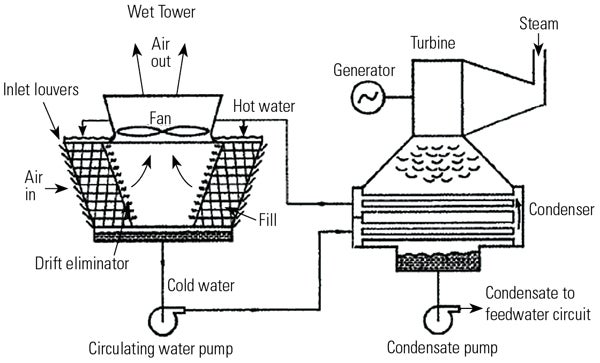

Recirculating or closed loop systems, such as wet cooling towers, are likely to become more prevalent should the requirements of Section 316(b) be fully implemented. In a closed loop configuration, the cooling water used to reject the steam heat is sent from the condenser to the cooling towers, which cool the water primarily through evaporation (Figure 1). As of this writing, the EPA has suspended the Cooling Water Intake Structure Phase II Regulation for existing large power plants in response to the 2nd Circuit Court of Appeals decision in Riverkeeper, Inc. v. EPA. (See “Looking Downstream after the Cooling Water Case,” POWER, June 2009.)
| 1. A recirculating or closed loop water system using a cooling tower. Source: Bechtel Power Corp. |
Even plants with sufficient water to supply a closed loop cooling system face many additional air and water permitting issues. For example, some of the circulating water may be entrained in the air stream and carried out of the tower as droplets or drift. These droplets contain the same chemical impurities as the recirculating water. Particulate matter (PM) components, defined as solid or liquid particles found in air, has been classified as an air emission by the EPA. PM is generated when the drift droplets evaporate and leave behind crystallized dissolved solids. PM10 (particles that are 10 micrometers or less) have been determined by the EPA to pose significant health risks to humans due to their small size and ability to reach the lower respiratory tract. Permit requirements in regard to PM10 and other emissions are getting stricter, requiring that lower and lower drift values be achieved from a cooling tower.
