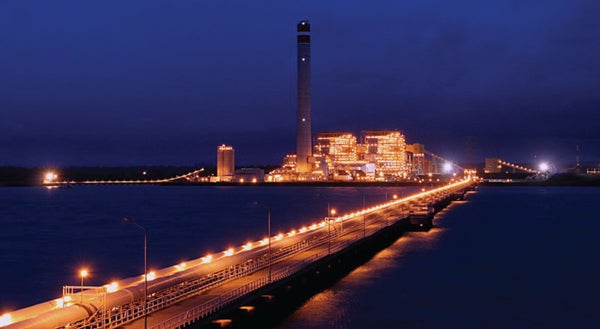

In central Java, the government also started up two new 662-MW units at the existing 1,320-MW Tanjung Jati B coal-fired power plant (Figure 5). The $2.06 billion expansion project was built by Japanese firm Sumitomo Corp., Wasa Mitra Engineering, and Bangladeshi power firm Summit Power Development Ltd. for Sumitomo subsidiary Central Java Power. Toshiba Corp. and Toshiba Plant Systems & Services supplied the turbine and generators, Mitsubishi Heavy Industries supplied the coal-fired boiler, Black and Veatch supplied auxiliary facilities for the boiler, and Mitsui Engineering and Shipbuilding Co. executed civil works. PLN has leased that plant from Central Java Power for 20 years.
5. Javanese giant. Two new 662-MW units were inaugurated in December at Central Java Power’s existing 1,320-MW Tanjung Jati B coal-fired power plant in Jepara, a coastal village a three-hour drive from Semarang on the Indonesian island of Java. Courtesy: Sumitomo Corp.
