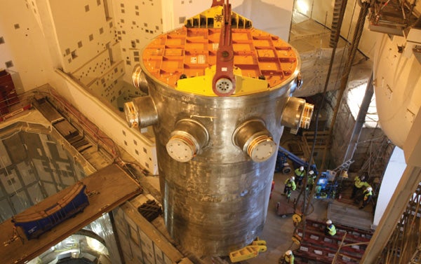

This June, AREVA installed the reactor pressure vessel (Figure 6)—the core of the unit—at the world’s first EPR project, which is under construction in Finland. Now the company will engage in a flurry of installation activities for heavy nuclear components, including lifting into the reactor the first of the four steam generators. Most of the work is expected to be completed by the end of 2012, with power production beginning in 2013.
6. Reacting to the pressure. AREVA has installed the reactor pressure vessel at the Olkiluoto 3 plant under construction in Finland, the site of the world’s first EPR. The steel component weighs 420 metric tons and measures 5.3 meters in diameter and 10.6 meters high. Installed using the permanent polar crane and a large movable crane, the remarkable technical feat follows the project’s last major milestone in September 2009, when the reactor dome was fitted. AREVA now expects the plant will be operational in 2013. Courtesy: AREVA
