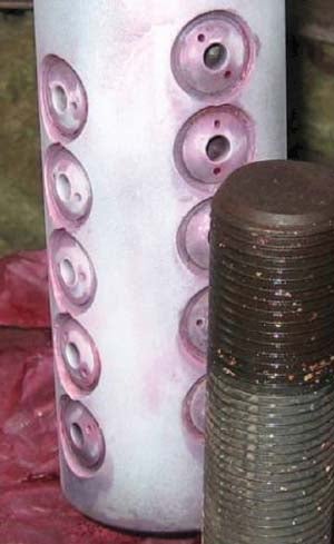

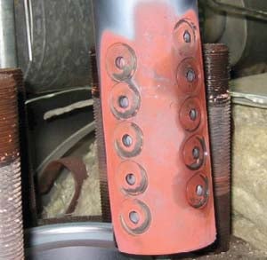

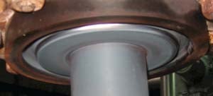

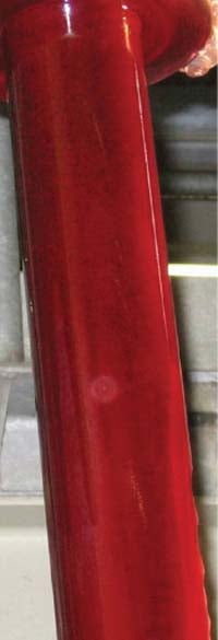

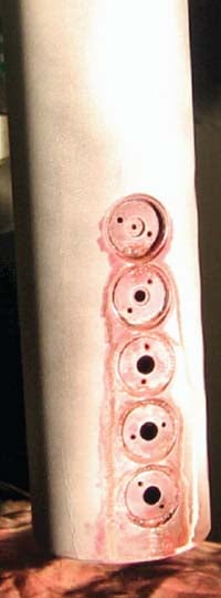

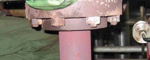

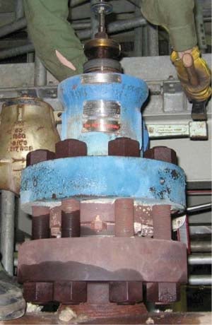

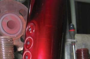

Tyco also maintains that, although other probe style desuperheaters require inspection and perhaps replacement every two years, the TempLow HT design will last for many more years. A recent inspection of an early installation in Spain after five years of service with no maintenance and zero leakage appears to confirm Tyco’s claims (see sidebar at the end of this story).

After five years of operation, the plant reports not one single leak, damaged probe, cracked nozzle, or pipe damage directly caused by operation of the desuperheater. Also, the desuperheater was able to sustain 1,150F steam temperatures without degradation. Avoiding unexpected outages to repair the desuperheater has paid good dividends to the plant given that each outage day penalizes the plant $200,000 to $250,000 in lost revenue.

According to Plant Director Pavel J.F. Rodriguez, the plant emissions-limited minimum load case for the plant is 230 MW. When operating between 230 MW and 280 MW, the outlet temperature of the combustion turbine is at its peak and attemperation in both the superheat and reheat lines is required. Above 280 MW to approximately 300 MW, attemperation may be required intermittently, although when is difficult to predict. Above 300 MW, the desuperheaters are in the closed position. The steam pipe connection on the superheat and reheat desuperheater is 4-inch with a 1½-inch water supply connection. The superheat steam line is an 18-inch OD pipe. The reheat steam line is 32-inch OD pipe.
The sidebar provides a photo essay of the first inspection of both desuperheaters after five years of service, in May 2009. Based on the inspection reports, these units have at least another two years of life remaining for a total of seven years of cycling service without major maintenance — a remarkable record. The first five photos are of the superheat desuperheater, and the second five photos are of the reheat desuperheater.
