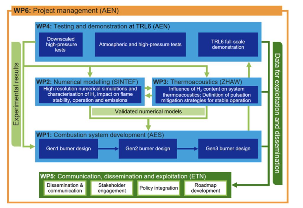

FLEX4H2 is a European-led project to design, develop, and validate a safe, efficient, and highly fuel-flexible combustion system capable of operating with any concentration of hydrogen blends in natural gas of up to 100%. The project, slated to wrap up in December 2026,  is being rolled out in interrelated stages. Courtesy: FLEX4H2
