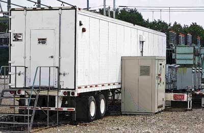

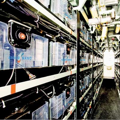

Inside the AES 53-foot trailer (Figure 7) reside numerous Altairnano Super Modules installed in racks (Figure 8). The batteries are air-cooled (the black circles in Figure 8 are the fans) in order to mitigate I 2 R heating in the modules. An air-conditioning system for the trailer keeps the temperature below 55C (131F).
7. Batteries on wheels. The Altairnano/AES 1-MW system can produce 250 kWh and is contained within a single 53-foot trailer. Courtesy: Altair Nanotechnologies
8. Modular arrangement. The batteries are arranged in racks within the trailer along with air-cooled fans, air conditioning, and various computer monitoring systems and controls. Courtesy: Altair Nanotechnologies
Various computer systems monitor and control all the Super Modules and associated systems. A battery management system monitors battery cell temperatures, balances the cell voltages as needed, and keeps track of the battery charge state. A programmable logic controller interfaces with three single-phase Parker Hannifin SSD inverters, one for each phase of the three-phase system. The Parker Hannifin SSD power inverters were coupled to isolation transformers and fed into a step-up transformer with the battery side running three-phase 480 V and the grid side operating at 13.8 kV. A supervisory control system monitors and interfaces with the step-up transformer sending and receiving power from the grid.
