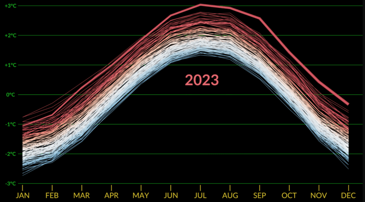

Notably, the STEO says sales of electricity to U.S. end-use customers are forecast to increase by 2% in 2024 and by 1% in 2025 after falling by 2% in 2023. The EIA said it expects a warmer summer this year “with 7% more forecast cooling degree days in 2Q24 and 3Q24 than the same quarters in 2023.” This is somewhat surprising considering 2023 was reported to be the hottest year on record. Scientists who maintain the world’s temperature records announced in mid-January that every month from June through December 2023 came in as the hottest on record for each of the months. In fact, July 2023 ranked as the hottest month ever recorded (Figure 2).
2. This graphic shows the seasonal temperatures variation on the Earth’s surface from 1880 through 2023 and how those temperatures deviate from the average from 1951 to 1980. The data come from the GISS Surface Temperature Analysis. The seasonal temperature offsets are based on the MERRA-2 reanalysis data. Source: NASA’s Scientific Visualization Studio
