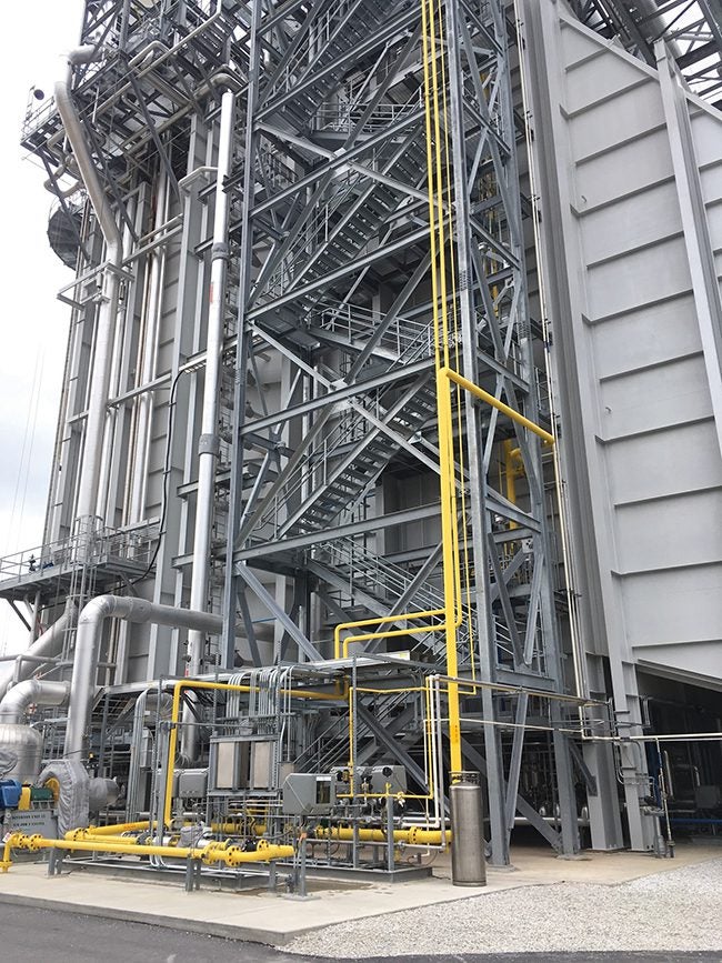

1. A typical combined cycle power plant duct burner system. Courtesy: Zeeco
This case study of one such turnkey duct burner system (Figure 1) replacement performed by Zeeco helps facility owners understand the pathway from diagnosis to start-up and demonstrates the benefits of eliminating aging equipment from a power plant’s infrastructure.

In 2022, a major electric-producing utility in the southeastern U.S. contacted Zeeco with concerns about its existing duct burner system. Zeeco performed an outage inspection and recorded findings, which included:
■ Badly warped flame stabilizers.
■ Pilot light failure for the main fuel flame of the burner element.
■ Poor flame scanner recognition.
■ Flame impingement on the downstream HRSG tube section.
Warped and distorted flame stabilizers can result from the inability to control the flame shape due to poor turbine exhaust gas (TEG) flow. This is generally caused by older designs that were always inadequate but unknown until the introduction of newer technologies. The simple aging process of combustion equipment subjected to years of cycling on and off also wears out flame holders and bluff bodies. In this case, both were noted as contributors to equipment decay.
The inability of the pilot to light off the main fuel flames can result from sagging burner elements. Additional causes for this failure are simply the destruction of the sparking device(s) that reside inside the HRSG furnace environment day after day at extreme temperatures. The general electrical circuitry of high-energy ignition systems is easily disrupted by water vapor from the TEG and open conduit systems, which can often be soaked with stormwater. In this case, the sagging of the burner element was the primary cause of the pilot’s failure to light the main fuel. The sparking tips were no longer in the pathway of the main fuel and never stood a chance to light.

Nearly all turnkey installation projects produce some discovery that identifies unknown issues before the start of demolition of the existing equipment. In the case of this project, the discovery was serious internal corrosion to the HRSG carbon steel casing walls (Figure 3). This type of discovery is increasingly common for older HRSG and duct burner equipment, specifically when HRSG units are originally installed near marine environments, or in places where temperature extremes may cause the exposed casing, enclosed HRSG wall insulation, and the HRSG internal floating liner plate system to work extraordinarily hard.
3. This image shows corrosion on the casing wall of the heat recovery steam generator. Courtesy: Zeeco
Other common discoveries for these types of HRSGs and duct burners are internally corroded fuel piping, reduced wall thicknesses of the pressure piping, and valve seat corrosion or destruction. These issues develop over time due to varying fuel temperature fluctuations throughout the plant’s fuel piping infrastructure caused by changing weather and seasonal conditions. The external piping was already scheduled for replacement for this project with new corrosion-free piping, fittings, and valves.
The Solution
This turnkey duct burner replacement project was planned to keep in mind those common types of discovery. Each potential discovery is discussed with the customer before finalizing the purchase of equipment and turnkey installation. Mitigating discoveries upfront through detailed planning creates a performance schedule that is as accurate as possible to real-world scenarios and helps eliminate surprises.
