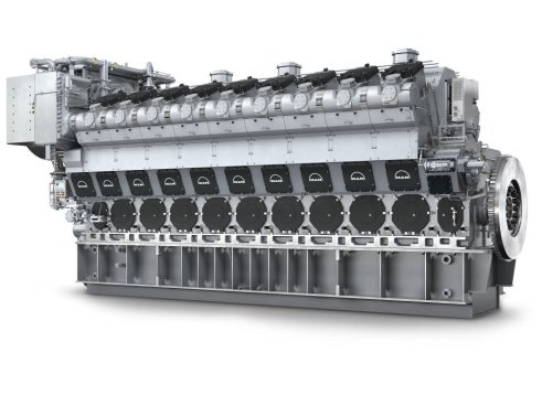

MAN_ES_51_60_engine
As part of a so-called lifecycle upgrade, MAN PrimeServ will convert 3 × MAN 12V48/60A and 2 × MAN 14V48/60B engines to modern MAN 51/60 types (pictured).
