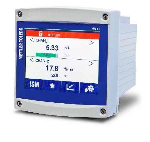

METTLER TOLEDO offers its M800 transmitter with a deionization capacity monitor called DI-Cap. This tool uses the high-purity UniCond conductivity sensors and a flow rate sensor to calculate the remaining resin capacity, allowing users to regenerate resin at precisely the right time. DI-Cap works by measuring the feedwater conductivity and converts this to total dissolved solids (TDS) using an adjustable conversion factor and algorithm. This non-linear algorithm corrects both for the conductivity of the water itself (needed in pure water ranges) and for the decreasing activity coefficient of ions at higher concentrations. Flow rate is also measured and multiplied by the TDS value. The product of these measurements is integrated over time to calculate the ionic load entering the DI column.
With this system, an accounting is made for both variable flow and variable water composition to give the best available estimate of ion loading.
