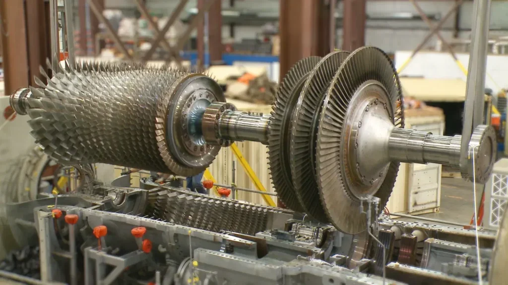

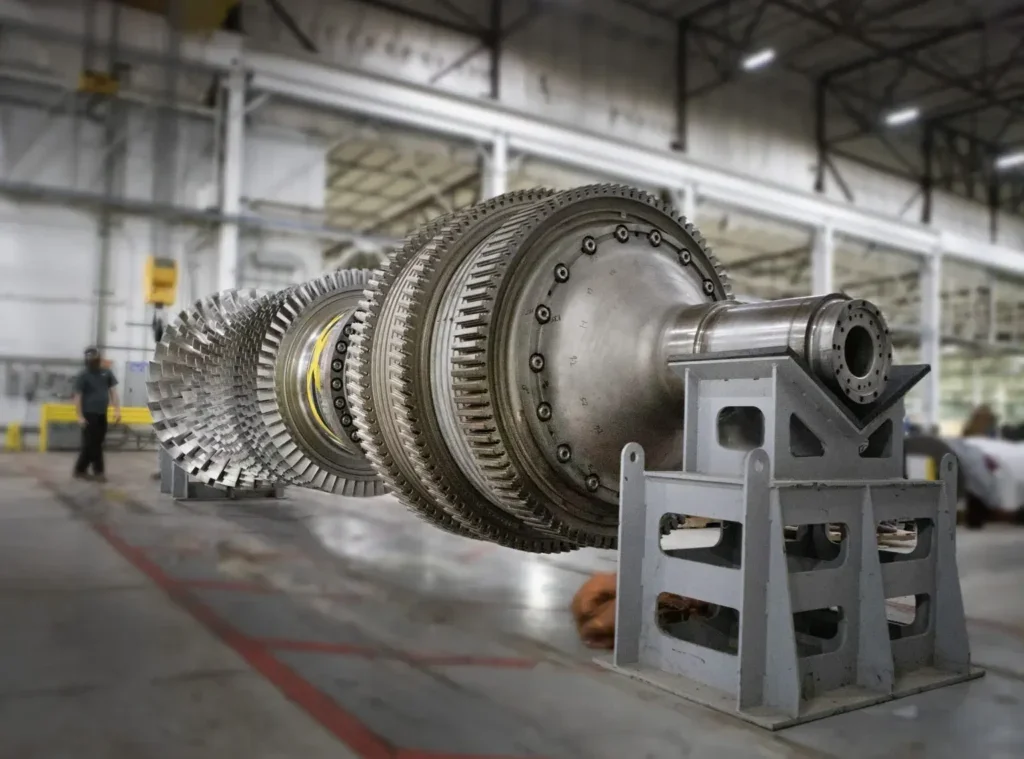

MD&A’s 7FA.03 gas turbine rotor

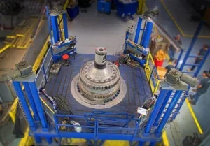

The foundation of MD&A’s reverse engineering effort was the acquisition of a 7FA.03 gas turbine & 7EA gas turbine, both of which had never been fired. Kevin Roy, MD&A’s Principal Engineer, Parts, who led much of the reverse engineering work, explained why zero-hour components were essential.
“You need something that is exactly as it was produced,” Roy said. “Those parts having not run, they’re exactly as they left the machine shop and left the factory. You don’t want to have to worry about how parts have worn over time or if they’ve deformed, trying to back into what it could have been.”

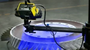

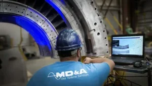

The reverse engineering process involved far more than dimensional scanning. Teams employed a combination of hand tools, coordinate measuring machines (CMM), and blue light scanning to capture geometry. But critical characteristics like coatings, shot peening, and surface finishes required hands-on expertise that no laser could provide.

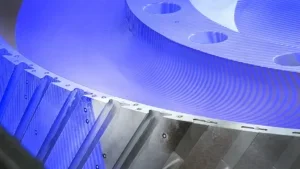

Reverse Engineering Gas Turbine Capital Parts
“It takes a lot of expertise and experience to understand what a coated part looks like versus a shot-peened part, what surface finishes are—all things that you’re not going to get from a laser scan or from a CMM measurement,” Roy noted.

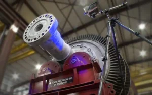

Material characterization came from separate used components that could be destructively tested, while the unfired parts provided pristine geometric references. MD&A’s parent company provided metallurgical support and testing capabilities that proved essential during the development phase.

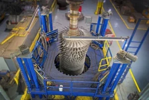

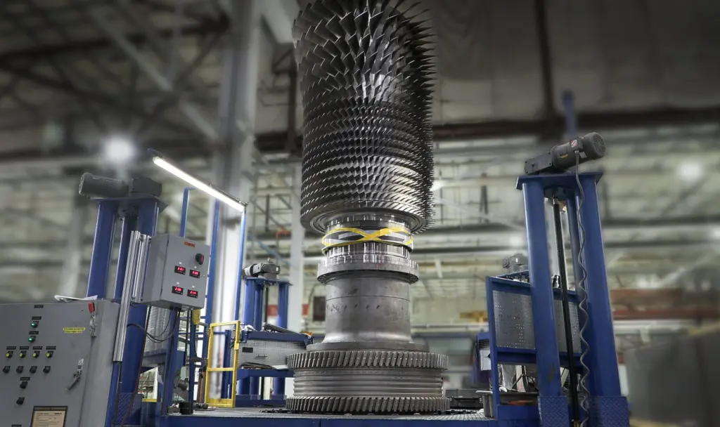

MD&A’s approach centers on minimizing customer downtime through a seed rotor exchange program, a model the company already operates successfully for 7FH2 generators. Rather than having customers wait while their rotor undergoes inspection and refurbishment, MD&A aims to maintain ready-to-install rotors that can be exchanged, limiting outages to the time required for removal and reinstallation.
“The downtime for customers that come our way for rotor life extensions only involves disassembly, putting the turbine on a half shell, removing the rotor, putting it on stands, taking the rotor that we’re providing, putting it into the unit, reassembly, and startup,” Fernandes explained.

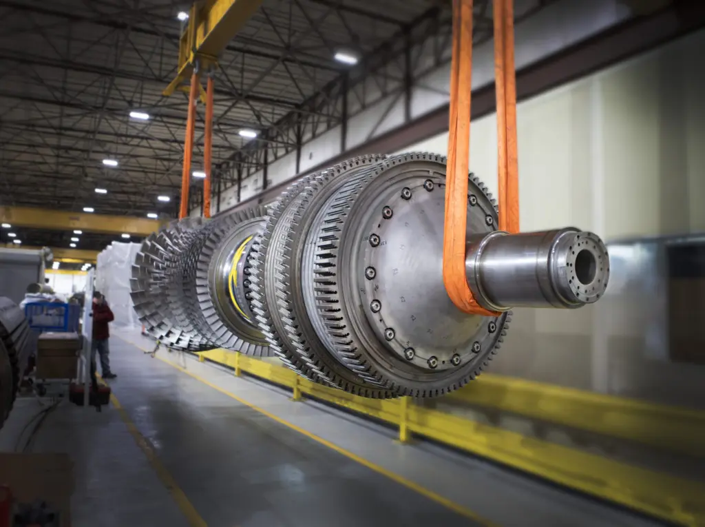

MD&A Turbine Image

MD&A has completed several 7FA & 7EA rotor end-of-life inspections and refurbishments, but the 7FA.03 rotor currently in the St. Louis shop represents a milestone. It’s the first 7FA.03 rotor purchased specifically for the company’s seed rotor program to go through the full production cycle with newly manufactured MD&A components integrated alongside serviceable original parts.
“There’s a fear that what you’ve done over the past 10 years is not going to line up, not going to be correct, not going to mate up to old-run mating components,” Wheeler acknowledged. “On the rotor that’s stacked right now, there are a couple of new wheels intermixed in the middle of a compressor with a bunch of old wheels. They mated up to the old wheels perfectly—as expected and designed.”
