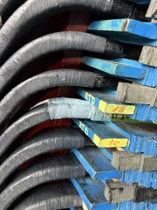

MD&A Stator Wedge Installation In Progress

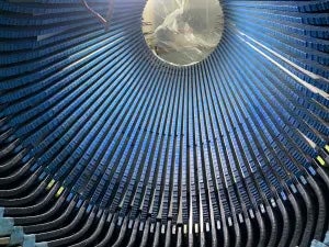

View of CE – Stator Rewind Complete

For wedging, a tapered low-shrink black canvas (LSBC) wedge and slide design with a top ripple spring was selected for sufficient radial pressing force. Filler was adjusted at each wedge for proper compressive force. Center and body wedges were installed throughout the core, followed by end wedges cut specifically for each of the 72 slots.
MDA Stator Wedge Installation In Progress

After the generator stator rewind, comprehensive electrical testing included copper and insulation resistance, final DC HiPot, and DC leakage testing of each phase. All testing results were verified and accepted.
A final crawl-through inspection was completed with the owner/operator. Field installation could begin, and the generator would soon be returned on schedule for dependable, long-term operation.
