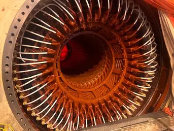

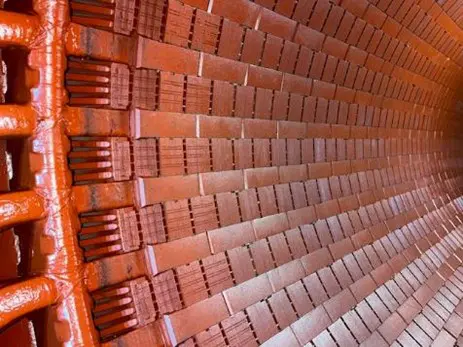

After generator rotor removal, MD&A experts performed onsite generator stator testing, including visual inspections of end windings, end winding support and core in addition to back iron areas.
Typical View of Stator Core
Initial inspection showed areas of oil pooling and greasing that were cleaned by MD&A. Inspections of the core laminations did not show any evidence of heating, damage, fretting or movement. No greasing of slot wedges was found, and no debris was found in the core areas.
MD&A’s baseline pressure decay test results indicated that the unit did have significant leaks in the stator winding cooling system.
Electrical and mechanical testing in this project also included winding insulation and polarization index, ELCID core iron testing, wedge mapping, bump testing, and qualitative thermocouple function tests, among others.

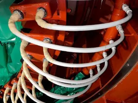

Hose Replacement
As part of this system outage, the owner/operator contracted MD&A to replace all generator Teflon cooling water hoses and perform the associated tests and inspections. All Teflon cooling hoses were manufactured by MD&A’s Turbine-Generator Repair Facility in St. Louis, MO, and were onsite well ahead of the need date.

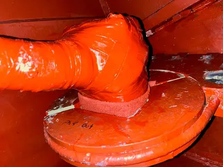

Conforming Putty Was Applied to the New Hose Connections
The owner/operator requested that MD&A replace all the seals at all terminal locations. This additional work included replacement of all O-ring seals in the terminal connections (4 per terminal).
The radial O-ring that seals the interface between the gas-side terminal and the top of the bushing was the primary leak point. Further, there is a separate connection point above the bushing that has an identical connection point with two identical seals. All four seals were replaced on all six terminals.
Hoses were installed with new O-ring seals and connection points were contoured with mica/epoxy then insulated with mica tape saturated with air-dry epoxy. An outer layer of glass tape was applied to the insulation before painting.
Terminal Connection After Seal Replacement
MD&A testing with localized helium tracer gas followed by pressure decay testing indicated that the leaks were repaired.

Stator Unit After All Work Completed
