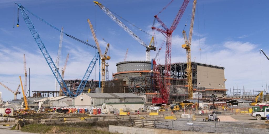

President Barack Obama on Tuesday offered to conditionally guarantee $8.33 billion in loans for Southern Co.’s project to build two AP1000 nuclear reactors at the Alvin W. Vogtle Electric Generating Plant in Burke, Ga. The pledge marks the first federal nuclear loan guarantee, and it could boost construction of the first U.S. nuclear plant in more than 30 years. More commitments are on the way, the Energy Department said.

The Alvin W. Vogtle Electric Generation Plant is one of Georgia Power’s two nuclear facilities and one of three nuclear facilities in the Southern Co. system. Southern Nuclear, a subsidiary of Southern Co. since 1990, is the licensed operator of Plant Vogtle, which is located about 25 miles south of Augusta, Ga.
The plant is jointly owned by Georgia Power (45.7%), Oglethorpe Power Corp. (30%), Municipal Electric Authority of Georgia (22.7%), and the Dalton Utilities (1.6%). Units 1 and 2 consist of Westinghouse four-loop pressurized water reactors rated at 1,109 and 1,127 MW respectively. Unit 1 began commercial operation in 1987; Unit 2 followed in 1989. The federal loan guarantees could boost completion of two 1,100-MW AP1000 reactors, which are currently scheduled to be completed in 2016 and 2017. (For more about the plant, see POWER’s November 2009 feature on the facility, “Plant Vogtle Leads the Next Nuclear Generation.”)

But that issue alone could pose hurdles: The Vogtle project has recently faced increased scrutiny, owing to the NRC’s Oct. 16 notice to Westinghouse Electric Co. that it had not adequately demonstrated the structural strength of certain components of its AP1000 reactor design, specifically for the shield building.
