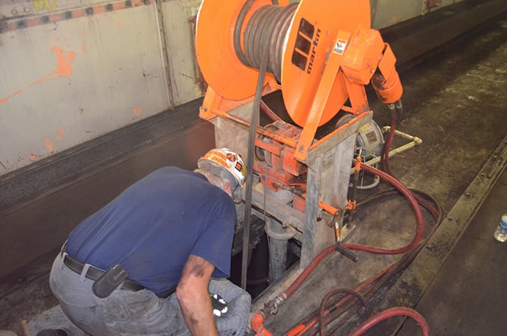

Most cleaning projects are performed by technicians using a portable, remote-controlled tool that can be lowered into storage vessels through a manhole opening. Powered by compressed air, the heavy-duty whip can be equipped with a variety of flails and cutting edges to knock down accumulated material without damaging storage vessels. Abrasion-resistant steel chain is best suited for most applications, with nonsparking brass chain for combustible materials. Urethane flails can also be employed to protect lined vessels that could be susceptible to damage from metal tools.

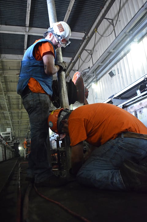

“With this technology, the need for confined space entry is greatly reduced,” observed Martin Engineering Silo Sales Specialist Marty Yepsen. “The equipment can be set up quickly outside the vessel, and it’s portable enough to move easily around various bin sizes and shapes.”
2. Technicians use remote-controlled equipment from the top of the vessel to safely address blockages. Courtesy: Martin Engineering
The whip uses a modular boom arrangement that extends from 2 meters (7 feet) up to 8.5 m (28 ft) and can clean vessels up to 18 m (60 ft) in diameter and 68.5 m (225 ft) tall from a single central opening of just 450 mm (18 inches). The pneumatic cutting head delivers powerful whip action to remove buildup from walls. The hose reel separates from the boom assembly for transportation and set-up in tight spaces.
