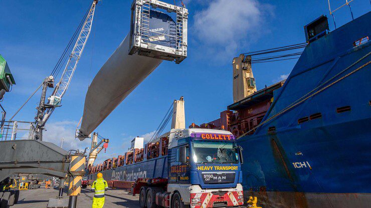

“This milestone project is a significant addition to our renewables portfolio, and we are proud to have contributed to Ireland’s renewable energy goals,” the company said. The delivered components included nine nacelles, hubs, and power trains; 36 tower sections; and 27 blades, which had been stored at and were loaded from Port of Waterford, Ireland (Figure 1).
1. Project components were loaded at Port of Waterford, Ireland. Courtesy: Collett & Sons Ltd.
